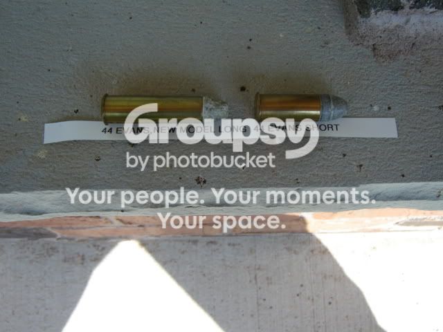

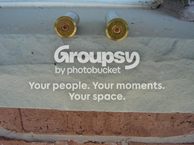

In case members are wondering what the ammo looks like for these guns, thought I throw up a couple of pics. Being from the east coast and these guns were made in Maine, we used to see alot of these in N.B. I actually have owned a few in the past and shot one. Go ahead and get the heat gun out, melt the wax and get to the range.
Both od these cartridges are Winchester head stamped.
1) 44 EV. N.M. W.R.A.Co. (Long)
2) 44 EVANS W.R.A.Co. (Short)
