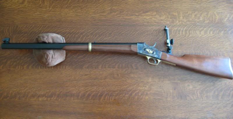

Man, you ain't kidding! Thanks for that. Loaded to those exact specs and took out my 26" Pedersoli RB:
(for shame, I know, I caved... don't have the resources to build an antique right now...)

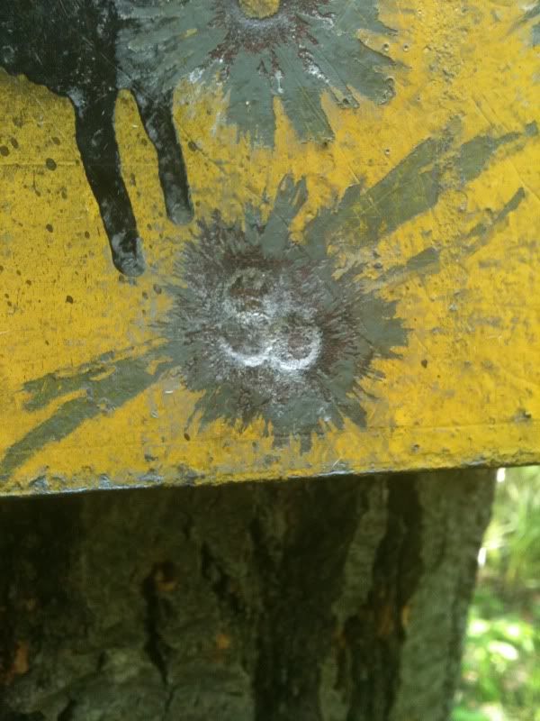

Took it out and these were my first three out of the pipe @ 100yd before I started to walk it up the gong. The rest of the groups were in the 2" range as well.
Might've been the best shooting I've done!
Sorry for the hijack. But I think I can endorse that load...
