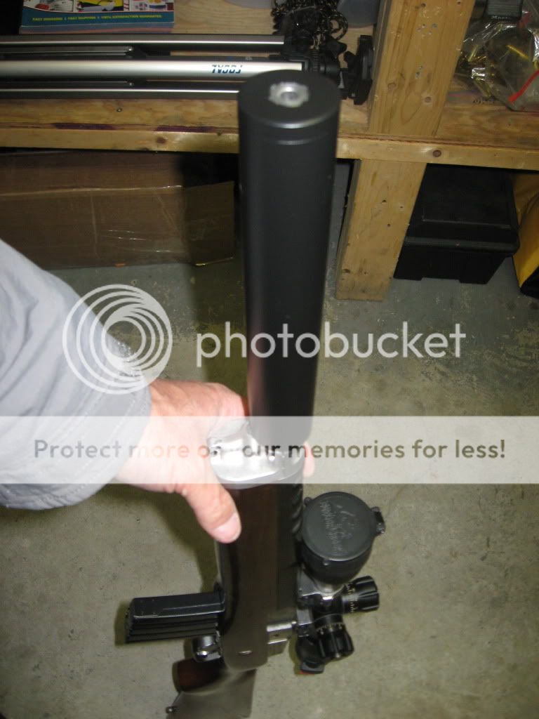

To start I put a barrel stabilizer that I made on it.

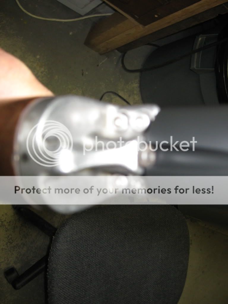

Got that idea from clarkcustoms website, also I drilled and tapped my gas block and installed a 4mm allen screw in, so now it is adjustable.
Also when tightening the gas block screws torque them to 16ft-lbs and use a feeler gauge and keep the gaps between the two gas block halves even. This will cause the barrel to walk straight up when it gets hot instead of to the right or left. The stabilizer acts as a heat sink and is 1-1/4OD alumimnum.
It also acts as a harmonic damper, I get about 10 shots before it gets hot and walks up, but at least its up.
