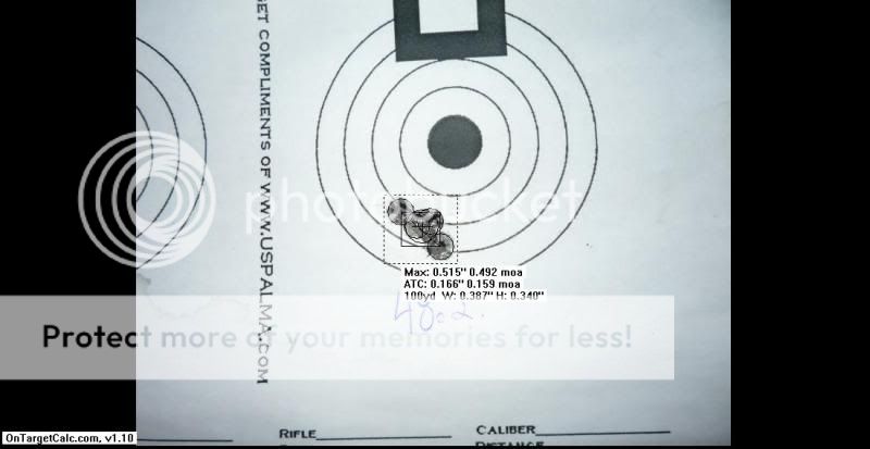

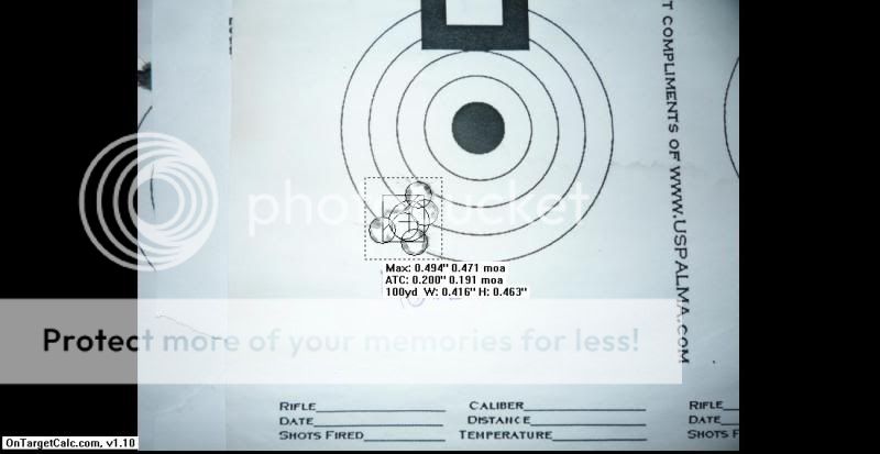

Well after some mediocre results with H4350 I switched to H4831SC and found what I was looking for.

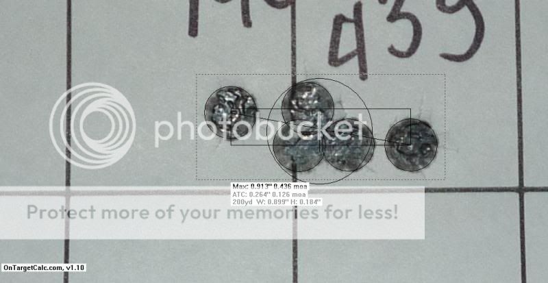

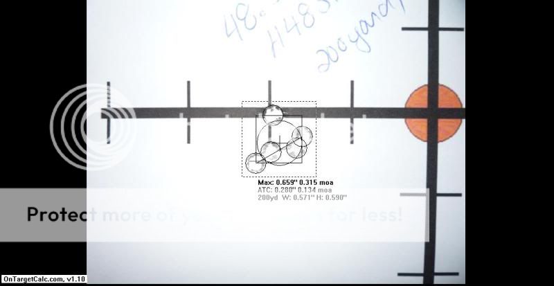

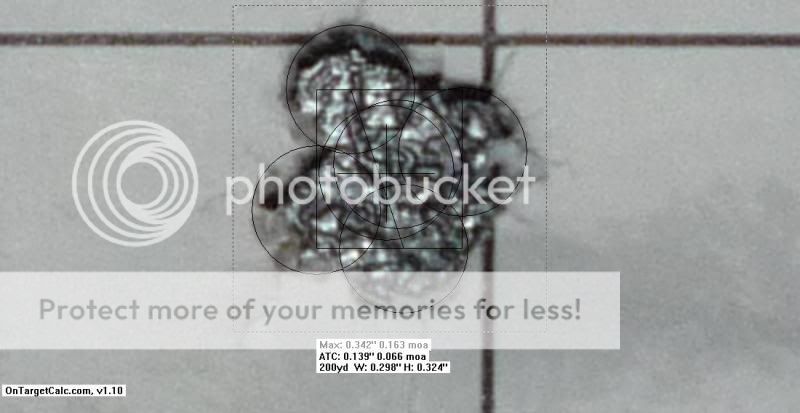

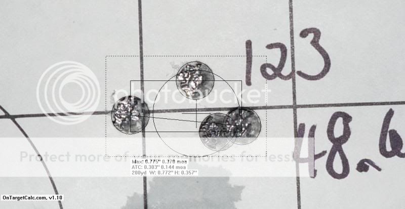

This is shooting 48.2-48.5 grains of H48831SC with 123 Grain Lapua Scenars. Brass if Win .243 neck turned just enough to skim. The first target is 200 Yard, the rest at 100. If I pushed it up any further groups opened up past 3/4" If I can keep em under 1/2 I'm happy with that.

The tightest one was 48.4 grains H4831SC 123 gr Lapua 10 thous jam. I think I will leave it there. Only had 10 rounds in that load. Gonna load a few more once I have better brass. H4350 would just not work for me.
