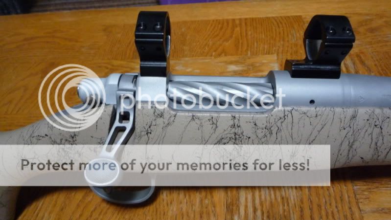

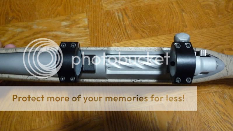

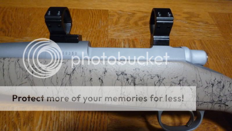

Thought I would post this, although the 'project' is not yet complete as I am waiting for a scope to come back from Leupold with an M1 turret installed. I've got a 2.5-8x36 for this rifle.
This is my new Model 7 project rifle.
McMillan Mtn Rifle EDGE stock (bedded)
Slabbed Action
Bolt Fluted
Bolt Handle Skeletonized
PTG Firing Pin/Shroud Assembly
Talley LW's
Bead Blasted
Tuned Trigger
6lbs as pictured. Work done by brno284 from the site!
Shot it yesterday and it shoots Remington factory 150 Corelokt well under MOA.
Loaded up some 160 Accubonds and was getting 2980-3010 fps with 59.0 and 59.5gr of Hybrid 100v with zero pressure signs from my 22" barrel. Dont think I'll push the speed envelope as this load seems very accurate as is!
I MAY cerakote the action black next year....havent decided yet though. Thoughts?
