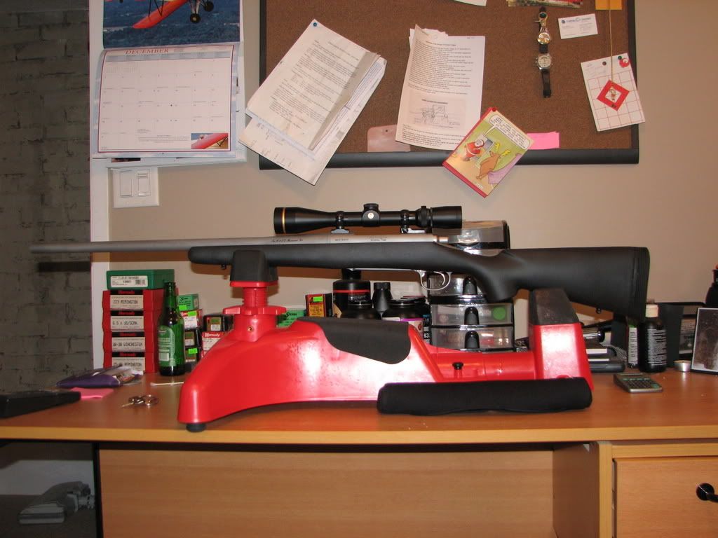

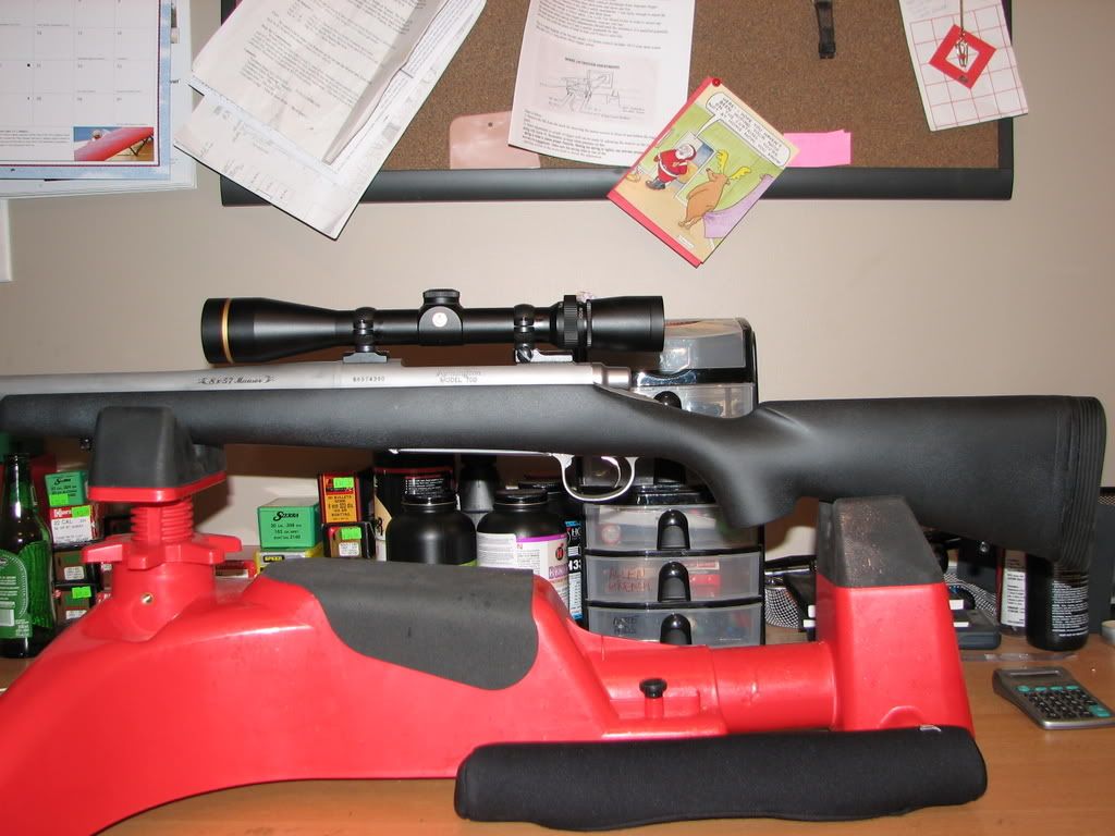

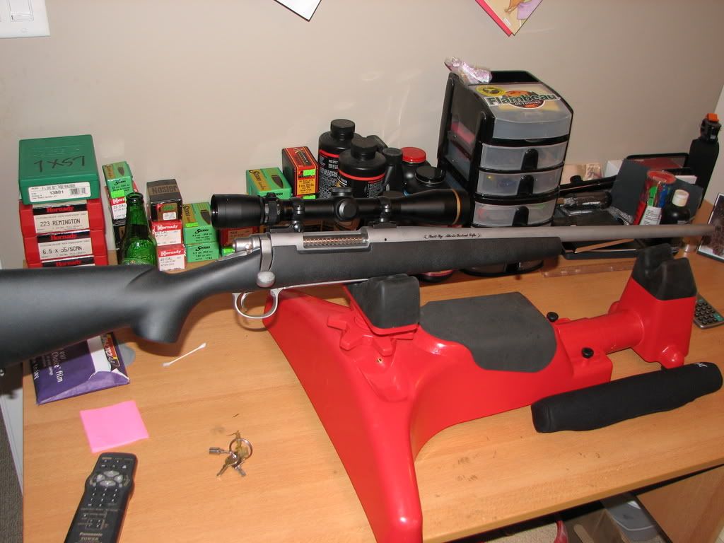

I had a 30-06 Rem. SPS stainless that I had no interest in using and I always wanted a new 8mm Mauser, I have had a few old ones, so I had Rick at Alberta Tactical Rifle Supplies put a new Lijla 8x57 barrel on it for me. The barrel is 20" and a little heavier than the original barrel. He also cleaned up the actions operation and adjusted the trigger to 2.5lbs. When I recieved the rifle I was very happy with it but I wished I would have put a better stock on it. So with out even firing it I ordered a used HS percision stock and installed it. I bedded the action and floated the barrel. I also refinnished it as I did not like the original color. It now looks like a very fine rifle even though it is not wood and blued steel. I then mounted a 3.5-10x40 VX-III with a Boon and Crocket retical wih Leupold mounts. I then procieded to try some reloads. I decided I was going to use one bullet and as I am a Nosler fan I decided on the 180gr BT as it is a well built hunting bullet with a good BC. I first tried IMR4064 and found that my best accuracy (.40" @ 100m) was with 44grns and pushed the bullet at 2450 fps. The accuracy was awsome but the speed was too slow as I wanted 30-06 preformance. As I increased the load accuracy went south fast. I then tried R15 and worked my loads up to 49grns with good accuracy, best group being .45" @ 100m. The bullet averages 2780 fps. I am very happy with the rifle. Rick Timmons did an awsome job on th gunsmithing and I did my best work on the stock. The rifle resembles a tactical rifle but I am goung to use it as an all weather, all purpose hunting rifle. I guess I am just posting this thread because this was my first semi custom rifle and it has been an awsome experience. I am also trying to spark interest in the 8x57 as a excellent north american hunting cartridge. Please forgive the spelling and here are some pics, if they work.
