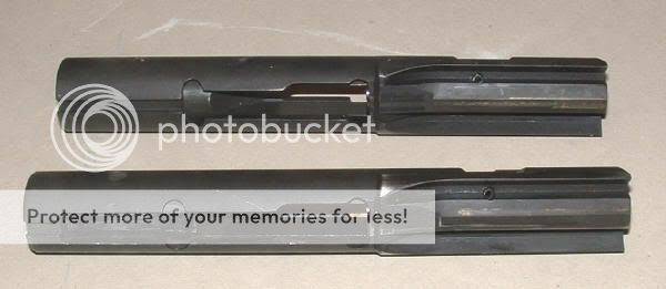

What is this ramping of the "bolt" ? isn't it the "carrier" that should be ramped ? Can someone explain more clearly or post pictures of ramped vs non-ramped "bolts" ?
I also want to build myself a 9mm lower and plug it on an RRA 10.5. But I like so much the CMC supermatch single-stage trigger on my .223 AR ! I want one in my 9mm.
Sorry for the confusion. Ramping the carrier makes the trigger recocking more gradual, its suppose to minimize the stress of the pins ( holes from egging out , pins from walking)

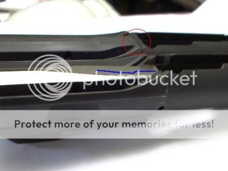

As you can see from pic below of a RRA carrier, a match hammer like the CMC gets caught in the notch as the bolt travels forward. This locks up everything so bad you need to drop both takedown / pivot pin out to free it up. Also you cans see trigger gets cocked after a very short amount of bolt travel
After ramping, the cocking is much more gradual . Notice the ramp is similar to a standard AR ( 223 ) carrier now.
You can feel the difference. With a unramped carrier, as you pull the carrier back, you can feel how quickly the hammer is cocked. With a ramped carrier, you need to pull the charging handle back further before hammer cocks
