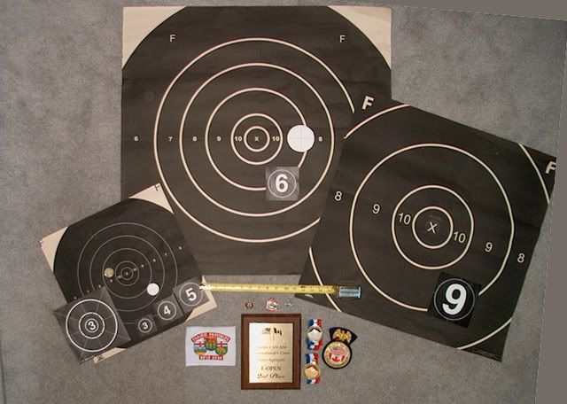

The year's matches were again pretty good. Started things out in March at Sacramento in the CanAm matches(Pairs shooting), didn't get any bling but had a great time and shot pretty well, best there were 100-8x at 300 yd, 100-5x at 500 yds, 99-4x at 600 yds, 98-5x at 800 yds, 92-2x at 900 yds and 88-0 at 1000 yds. I was my first time shooting on the US F Class targets and they are tough let me tell ya'!
Here's a picture of them (300 yd, 600 yd and the LR 8,9,10 target) with add in centers the APRA uses and the white dots we shot at in BC prov's. The coin on the 300 yds is a toonie for sizing along with a tape measure, and my bling from last US match

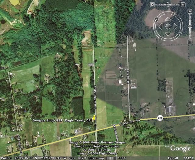

Inspector, myself, B. Watts and Ron Herms (also a SPRA member) joined up to make the PPRA Rifle team. Only managed middle of the pack in BC myself, then down to Douglas Ridge Rifle Club South East of Portland, near Clackmas OR following the BC Provincial match, which makes up the PNW F Class International match (also shot in pairs like here in Canada)

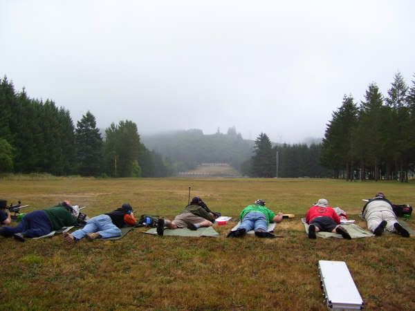

Fog/mist at the 800 above

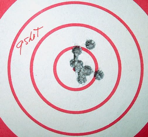

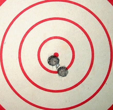

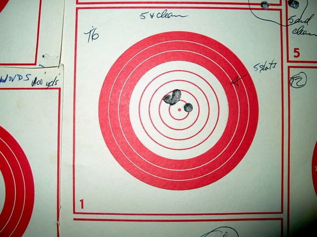

The new reamer is larger at the rear so I no longer have to use the small base die to size the bases way down. After the shot one and clean for 10 and a set of 2 rounds x 5 and clean at each set of 2, here is her first 5 shot.
Then her first 10 shot after cleaning again...

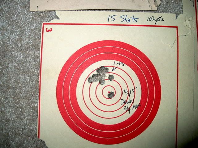

and 15 shot (I changed the scope down 3/4 moa of the last two rounds, I like to shot 10's eh...) after cleaning again...
And here's a 9 shot that same day...

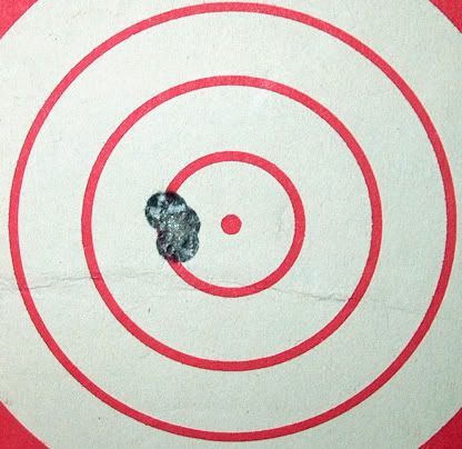

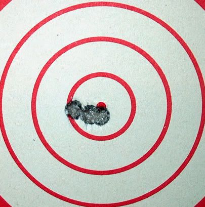

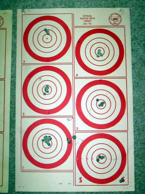

Here's the new/old 308 barrel's break-in using 247c or 39.7g of N135 and 154g FB Dalgetty bullets at 2718 fps - this is not a tuned load yet... just to break her in, but it does show some promise and it looks to be a good barrel. Note: shot 3 thru 5 thru this barrel (on the line between T1 and the Sighter) There is 52 rounds on this target... again at 100 yds without flags
Went out again after removing the barrel bedding in front of the action the following weekend, Sept 13th. This eliminated some of the verticle. Wind was a head wind from 7-12 mph. Load development for the 308, all shots at 100 yds without flags.
42.0g N135 with 154g FB at 2812 es10 sd5.5 - 3 shots
42.5g N135 with 154g FB at 2860 es14 sd7.8 - 3 shots
44.0g N135 with 154g FB at 2946 es12 sd6 - 3 shots
The last two loads (43.5 and 44g N135) should slight pressure so I'm going with the 42.5g load, even though the 44g load had the first 2 thru the same hole.
Shot the 308 first, then switched barrels to confirm the 6-250 still shots too.
9 shots thru the 6-250 - winds stronger, around 10-14 mph
I'm happy, both barrels shot as well as can be expected without any wind flags.

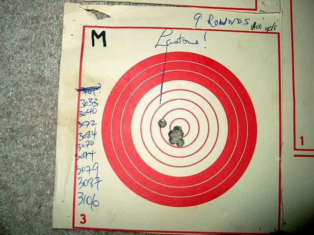

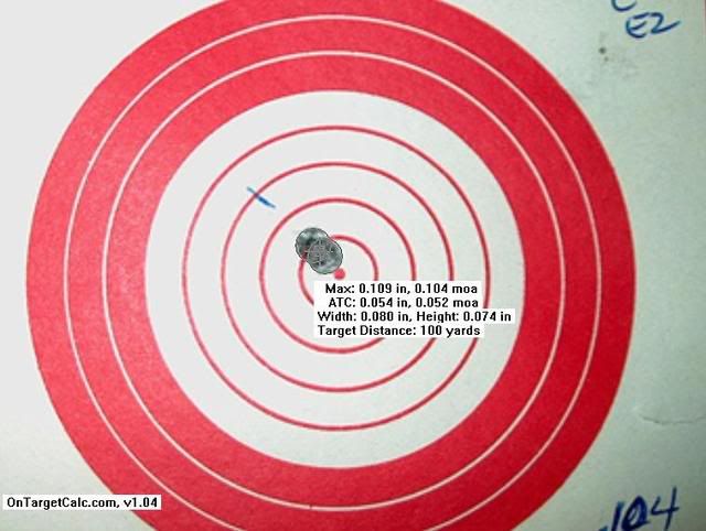

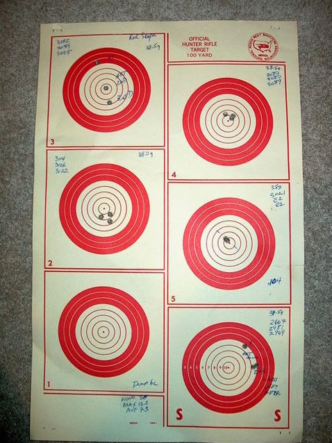

Went to again Sept 20th to test how far off the POI and the scope crosshairs are after removing and replacing the scope, and to re-test the 6-250 for the best load with the 105's again now that it is free floated (without changing barrels for this test but when I do change I have to R&R the scope so the action wrench does not take out the scope!) and found that you can be anywhere's from 1.25 moa to 3 moa out after R&R'g the scope! Ouch eh. But it was a great day, temp was cool at 6C or 42F, wind was SE from 7.3 to 13.2 mph, RH about 70%. I was really happy with the load I found at 100 yds using 2 wind flags and the wind meter at the bench, here's the best 3 shot group of the day. I know, 3 is not a group, 5 is, but this is just for load developement, not records
The white area is 2.500" in diameter and the 10 ring is 0.5". T5 is at 38g pf H4350 with 105 Lapua Scenars and goes 3021 fps, good, i.e., Sonic till just past 1400 yds!
T3 is were the R&R of the scope happened and T3 and T4 are the same load. I increased the load .5g per target, except T3 & T4. and shot them in S, T5, T4, T3, and T2 order like I do in HBR class.
