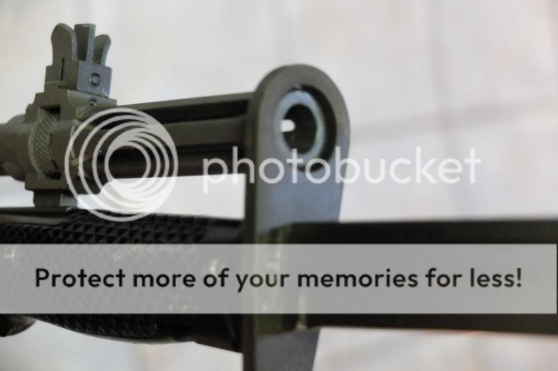

Further to the bayonet installation...
Here you can see how the pommel strikes the gas plug just before it's able to lock on.
I'm wondering if making a relief cut into the pommel could destroy the bayo--the plug contacts
right where the tang (handle shaft) is fixed to the pommel. Cutting into the tang may cause the
pommel to come loose. [: ^0
Here's how much more I need to move aft...
I'd like to find a plug like the stubby SOMCOM, except with a metric thread. I could maybe solve
the mounting problem by throwing more money at it-- Ordering a new SAE usgi/aftermarket
gas tube and piston plus the stubby plug, but then I'm getting near to what I spent on the rifle...
The other 'Plan B' is to find a machinist/gunsmith able and willing to turn out a plug for me that
won't cost as much as the rifle did in the first place :)0 |
I'm open to other ideas.

I'm notoriously cheap and always looking to fix things for as little as possible, so don't be offended by my suggestion.
Looking at the pictures there seems to be the possibility of shaving the head of the gas plug to get the clearance you need.
I realise this is a sacrilegious statement to many, but it is only a minor alteration.
There is probably some engineering/sciency reason why this is not advisable.
Good luck anyway.

Thx for the compliment and the suggestion. I am not offended by that idea. It's not that I'm 'cheap' so much as poor. I'd just love to spend the money to have nothing but top of the line equipment, but in fact, your idea was my very first 'Plan A' for fitting the bayo. The only thing is--
The plug is 7 mm thick at the front, and I need 5 mm altogether, so that much thinning would leave the head of the plug too thin.
I may be able to steal maybe half of the distance from the pommel, ie "splitting the difference" by shaving ~ 3 mm off the plug, and make a 3 mm
cut into the tang/pommel...
So that's now become my 'Plan of last resort' unless a better idea comes along that won't cost me several day's pay.
Stay tuned! :)0 ]

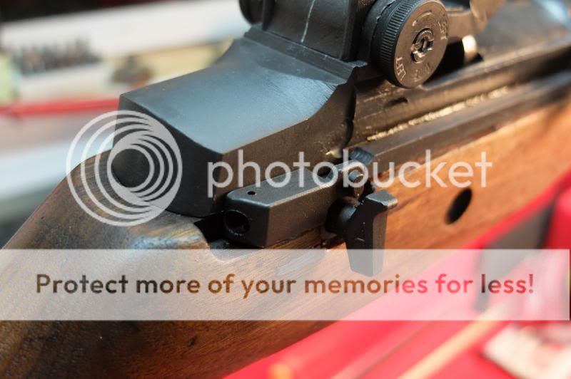

The next installment:
I'm not sure whether I did the show and tell about this mod or not... :confused:
I was considering ordering a selector switch from Brownells to fill that gaping hole in the stock, but.... What? Fifty dollars for a piece of el cheapo plastic?!?
No, it's nicely finished steel... Still... $50, eh?--ouch!
I rationalize : Ordering this switch will save me more than it would've cost me in materials and time to fill that gaping hole, plus I'm certain I would
have made a big mess with the patch. A dog's breakfast, eh?
Anyway, what's fifty bucks buy you these days? A bag of groceries? Food vs Essentials... What to do? Decisions, decisions....

Whoa! It looks a lot like the real thing. It even twists to a 90 degree detent when you press and turn it!
I understand how the long screw works. I suspect that the roll pin is there to stabilize the rear of the switch since no screw is made that long and skinny?
You drill a 7/64" hole into the stock, then drive the pin in? (Providing installation instructions is not their forte)
Ach, it's a nice fit, with no fiddly adjustments or trimming needed so, "mustn't grumble", eh?
And, yes, I'll have that epoxy patch all matched to the stock by next week.
IMO that selector switch looks much better than a "fill" job. Gives it a nice look. You're build is looking awesome!

... But it sure looks good. So it screws in nice n tight?
Yes, it's surprisingly solid. I put a dab of Gorilla Snot on the threads and on the pin before I fastened them down, but I prolly didn't need to.
Oh, yeah-- WARNING If you put one of these on,
you'll want to use a different method of racking the bolt-- If you're used to doing it with the palm of your right hand facing up and your pinky on the
op rod handle, the inboard edge of your hand will come to grief when it drags across the switch. I use my thumb on the op rod, pointing down, and have my palm facing in.
