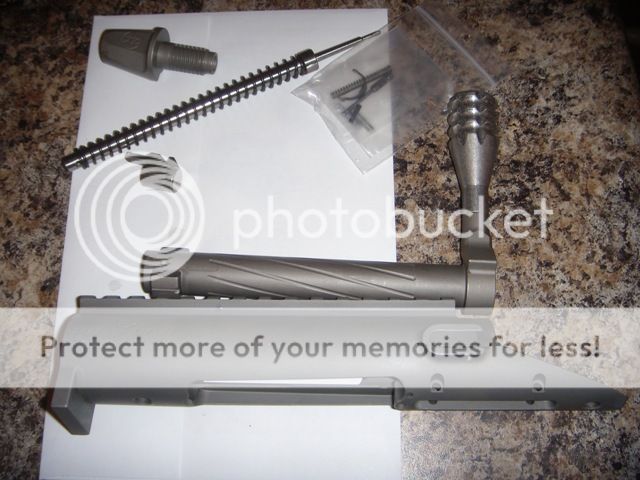

The .260 barrel is screwed on and test fired. Life is great. While I was assembling the bolt, I sent (who has never done this...) the ejector and spring across the shop floor. Found the spring and then I could not locate the ejector. :(
So I emailed the Surgeon Rifles people in Prague, OK and they sent me replacement bolt innards at NO CHARGE! Even if it was my fault. I was happy to pay for the spare: ejector, ejector spring, ejector retaining pin, firing pin retaining pin. What great service.

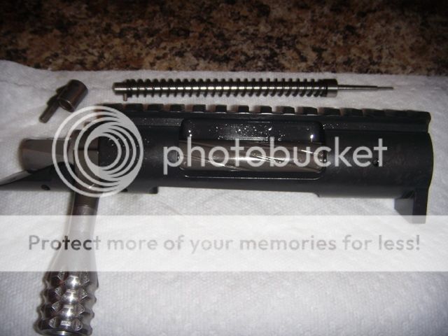

Here she is... all ready for the season....
The barrel is a .260 Rem take-off from a VLS 700 that I bought here on the EE Forum. I took the barrel off and sold the action/stock/receiver. Yup, I wanted only the .260 barrel in Varmint Rem M700 profile because I do have to hunt with the rifle, unlike those ultra cool, accurate, attractive, and also expensive F-Class rigs that give me a hernia just looking at them. :D
The barrel work was done by your moderator here on CGNutz, tiriaq... a great guy. Very meticulous and knows more about 'smithing' the M14 that I will ever know. :)
As I mentioned on the previous post, the brass mic's out at 2 to 3 thou above the 1.630" .308 GO Gauge and I'm super pleased. :cool:

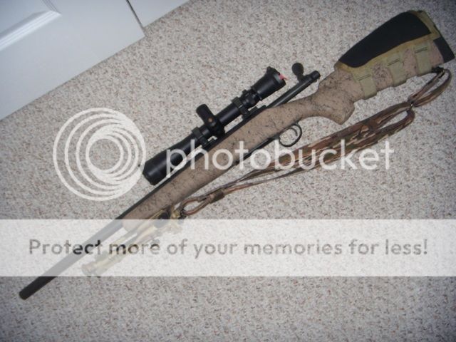

More pics... The scope is a Mark 4 M1 Turret LR 6.5 x 20 x 50mm TMR reticle. I wish it was a FFP but my first son is in 2nd year Chiropractic School and tuition is $22K per year. FFP ain't gonna be happening for a long while. Gotta work some overtime shifts to get one of those fancy optics... :D

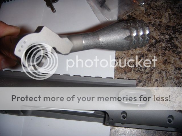

Of course, some of you will be asking what about that 20 MOA rail? Well, that's all part of the action. The attraction to the the Surgeon 591 is that the scope mount is machined into the receiver as part of it and acts as a super stiffener 'bridge'. So minimum flex in the action is key. :wave:
I'm running a pair of TPS rings from Brownells. Low height, 30mm and steel construction. All my rifles (not that many) run TPS rings, parts commonality. I like a company that sells spare parts for their rings. :cheers:
Bolt knob is a Badger Ordnance which is shorter than the ones shown in first post, first page; that was the factory bolt knob from Surgeon.
