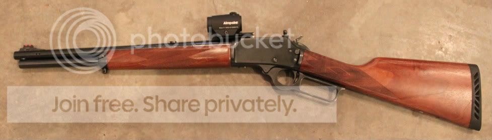

This thread inspired me to give the micro a test run on the 1894P.

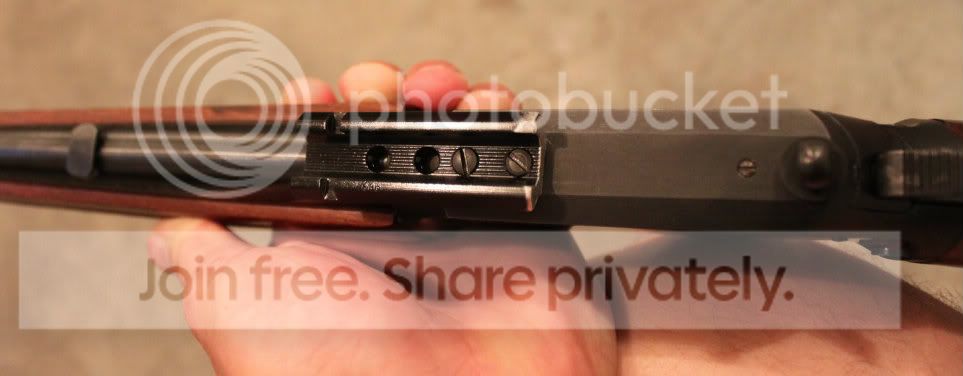

I'd heard of chopping the weaver base somewhere on the intranets before, and I had a spare one kicking around so...

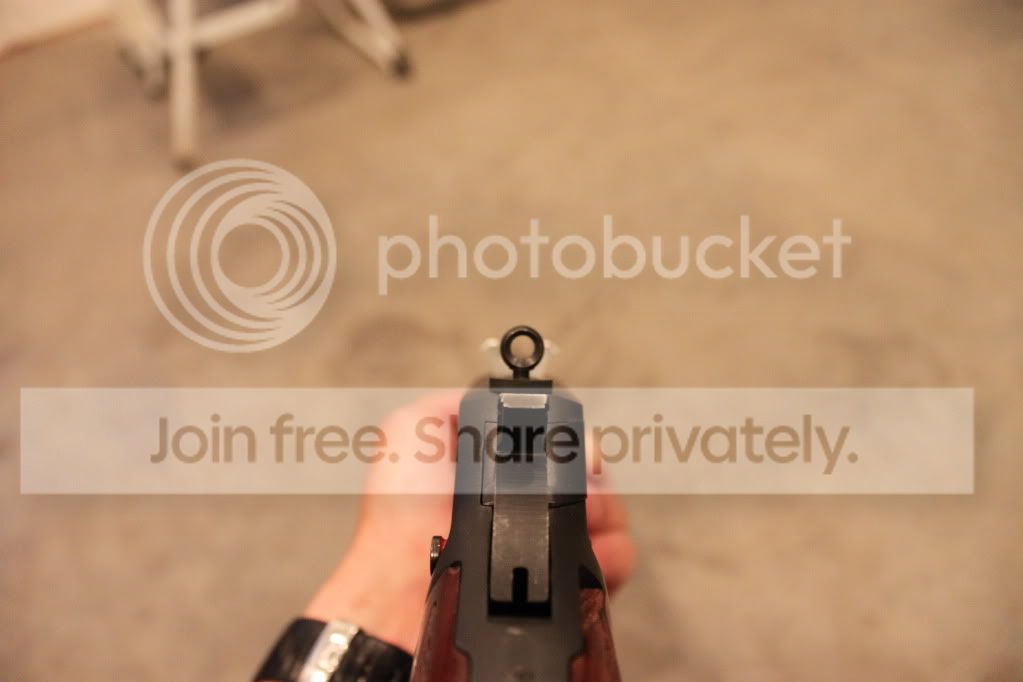

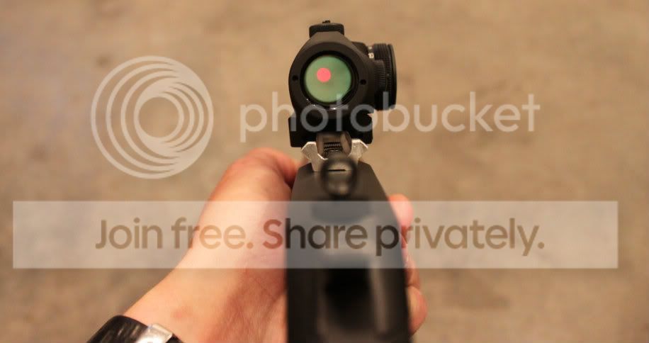

Cheek weld is still good, the irons are unobscured and very useable with the aimpoint removed...and the mount still catches two receiver screws and is strong. The weaver rail comes with six holes to match-up with the 1894,336 and 1895 series, so depending on where you make the cut you have a few options for eye-relief {not that it's an issue with an aimpoint...they are very forgiving}
Is it as aesthetically pleasing as the XS scout rail? Well obviously not but at a quarter of the weight and 15$ it's a pretty easy and solid set-up IMHO.
