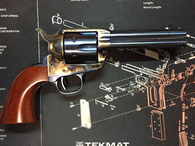

I picked up an Uberti 1873 Cattleman in 45Colt along with a 22LR drop-in conversion kit from Wolverine Supplies. Honestly, I wasn't planning on buying any new firearms for a while but the 2014 prices were too good to pass up. Originally I wanted the El Patron which was $15 cheaper but I sat on the fence too long (about 6mts too long) and someone beat me to it by a day! Mea culpa!
Here's my take on the Cattleman so far.
The Pros
After taking the opening the box and removing it from the plastic bag, it sure is a sight to behold. That colourful, mottled patina of the case hardened frame and the rich charcoal blue of the barrel, grip frame, trigger and cylinder just jumps out at you. It's just beautiful.
The Uberti Cattleman are well-built for the most part. I mean, they just feel solid in your hands and nothing rattles around. The grips are a little on the wider side and smooth compared to the slimmer, checkered El Patron grips. I have slimmer, medium sized hands and I don't mind the size of the stock grips. I just figured the checkered grips would be nice and offer better grip and I have no clue on where to purchase the El Patron grips.
Seeing that it's a Colt clone, I'm assuming that any Colt grips should technically fit? Hogue wood grips are an option but I've had some quality issues with the ones I got for my Vaquero and that's left a bitter taste in my mouth. First set were the wrong grips in the correct packaging and I got questioned on it until they finally decided to replace them. Then they sent some piss poor fitting ones which I had to send back. The replacements fit better but still not great. Anyhow, I digress...
Cocking the 4-stage hammer sounded cool. CLICK CLICK CLICK CLICK... or C-O-L-T. As cool as it sounded, it was a little on the gritty side but not terrible. The cylinder timing on my gun is bang on as the locking notches on the cylinder lined up perfectly with the locking lug. The trigger had a very tiny amount of creep but broke pretty crisp at 3.5lbs with THE tiniest amount of grit. It felt more like 5lbs but the trigger scale insisted it was 3.5lbs.

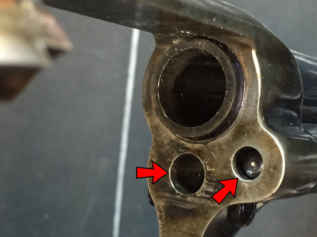

The frame has some sharp edges to it. You won't normally notice it with the cylinder in place but if you rub your finer around the cylinder opening on the frame, it almost feels like a knife edge.

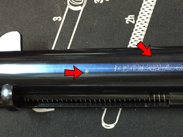

Working the ejector rod was not smooth out of the box. It would hang up consistently in either direction. I thought I noticed slight rusting in the ejector rod housing but that was just discolouration. The edge of the barrel, the cylinder and ejector rod holes were all sharp with light burrs on the latter. I discovered the burr on the frame too late and I'd already scraped the charcoal bluing off one side of the ejector rod. Not a biggie since it would eventually wear down on its own and not like it's noticeable.

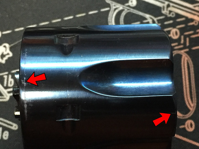

Next is the finish. As gorgeous as that charcoal blue looks, I've read that it is not very durable and prone to wear, not to mention, it's only temporary as the heat from shooting will eventually darken it. That said, out of the box, there were some scuffs around the cylinder face and side and some minor ones around the barrel as highlighted in the pics. Again, not a deal breaker for me but I know some folks are picky about these things.

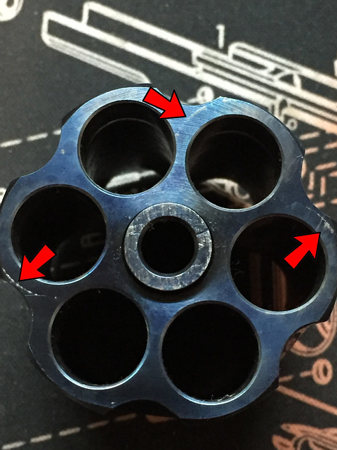

When I removed the cylinder, I noticed some wear on the bluing on the back of it and I realized that the gunsmith who worked on the frame did an ever so slightly uneven grinding on the front right side of the recoil shield by the loading gate. I could file down the high spot but doing so, I'll end up removing the finish. GRRRRR!!

Having spent the last couple of nights playing with the pistol, the grittyness of the hammer and trigger has diminished a bit. I've carefully dehorned the sharp edges/burr from the cylinder and ejection rod holes on the frame. The ejector rod now no longer gets hung up when worked, if anything it's partially the spring that's causing some very minor binding.
