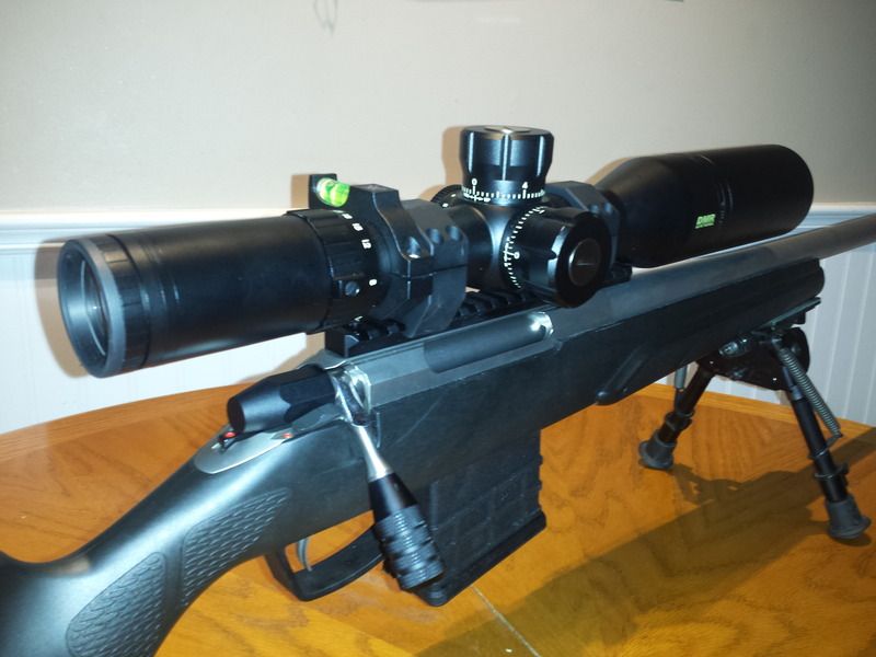

I have a very similar set up
Mine shoots extremely well with 80 gr SMK's or 82gr Bergers, Ive shot both rounds out to 1000 yards. At 100 yards its a solid .4 and better on a nice calm day. My best groups come with 10 thou off the lans.
Cheers!!
I run through the same rifle 75 gr Hornady A-Max #22792 with 24 gr of CFE223, with a total cartridge length 61.28mm. have to load in the chamber one at the time, because cartridge is too long to fit in tikka's 5round stock mag.

I recall a dude with a tikka 204 ruger getting 1/4" or 5/8" groups at 500 yards. 'Twas either measurement but one a the two anyhow lol. I'd like my tikka lite 223 to do that at 500 yards. I have the 1-8" twist on mine
I'm personally not bothering with the cheesy mag not having enough space. Got my Lumley arms bottom metal for AICS mags now so that should take care of that issue for me
Do u reload for this? I was wonder if the mag will accommodate 69 or 75 gr bullets without modification?
I change the trigger guard and mag for that, with the original mag, you can not shoot more than 55g, unless you put the rounds one by one!
With the Atlasworkx, or the Lumley, you can put rounds in the mag (MDT or AICS) with a COAL of 2.55 ''
