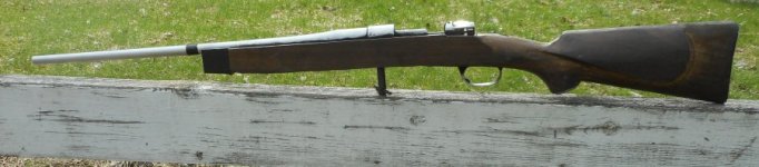

Caliber settled, it was time to design the rifle. There were only two real contenders for the action design, the pre '64 Model 70 and the Mauser 98. I've been a Mauser fan since I first started reading about rifles, so that part was easy. The best Mauser 98 actions, in my opinion, were the pre-war commercial sporters, and the Mauser Werke made a special one expressly for the .30/06. A donor rifle fell into my hands through one of the gun auctions.
This particular rifle had had a hard life. The bore had been neglected, and the stock repaired, so that eased my conscience about stripping down a vintage collectible sporter for the action. Then I had to acquire all the little bits and pieces.
The stock came from Prophet River, a medium grade of NZ walnut.
The new barrel was a Shilen blank, picked up from a fellow nutter
Now you need to acquire an after market trigger.
Intersurplus had some lovely double set triggers at a very reasonable price. They may still have some. They also had some very nicely engraved triggerguard/floorplate/magwell sets.
Are you going to D+T the rifle for bases?
Can you do the work yourself?

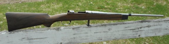

Putting it all together:

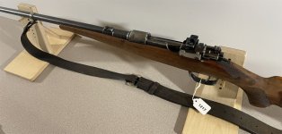

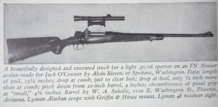

I found inspiration for the look I wanted in Jack O'Connor's Book of the Rifle:
Realistically, there was now way I was ever going to own this particular rifle, since it now resides in a museum, and there were some changes I wanted to make anyway.

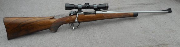

What I liked, was the reasonable barrel length of 22". I also wanted iron sights, not so much for a back-up, but because I just prefer open sights in some circumstances. I wanted a peep at the back, but I didn't like the huge lyman clamped on the side of it. Firstly, it limits your scope mount choice to some sort of side mount. Secondly, I knew from experience that I tend to smash my knuckle on the corner of them when running the bolt rapidly. So I needed some sort of detachable sight that would clamp onto the scope base, and it would also require quick detachable mounts of some variety. There are two options, XS sights, and the neat little Talley peep. I'm still not 100% sure which I'm going to use, but I'm leaning towards the XS.
The front sight on O'Connor's rifle appears to be a Redfield. I managed to track down something similar.
This is also a Redfield, but it has the band rather than just being sweated to the top of the barrel.
The problem occurred to me of where to keep this auxiliary peep. Keeping it loose in a pocket just invites loss, so it needed to be kept with the rifle. The solution was a trap buttplate, also provided by a gunnutter.

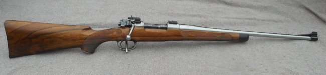

I meant to better document the building process. I would normally work on it a couple of hours a night, and it was progressing so slowly that I kept putting off taking pictures. I'm looking for a new project now, and I'll try to document the stock carving process from layout to completion.

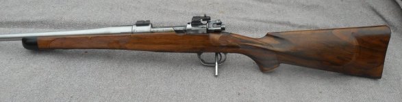

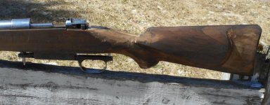

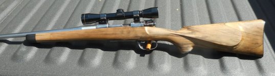

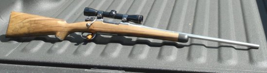

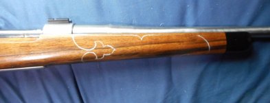

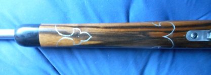

The checkering pattern is modified from a Dale Goens pattern found in Monty Kennedy's book. I have to say, checkering was hell. I wasn't happy with the way my first attempt turned out, so I shaved it all off. This set me back a few months because I had to set it all aside and regain my composure. Shaving the checkering off without sanding the whole stock gave it an "inlet" appearance, which I rather like, but dread doing it again.
Anyway, checkering and finishing is done, all that's left is bluing and the final fixing of the front sight. It's just press fit on there now, so I can play around and get the backsight sorted out.
The swivels are stuck in the mail. I was sending them to get a couple of buggered up screw heads welded, and CP went on strike a couple of hours later.

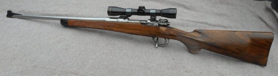

I'm looking to upgrade the scope too.
It looks pretty neat with a clean barrel too...

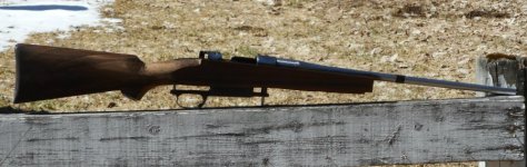

One of my GO TO rifle is my Remington m1917 that I got for a steal a couples years back.
I topped it of with a Riton 1-8x24 to shave weight.
It bring to the solder lire a glove for me.
I set on Shooting 208g hornady with Superformance powder.
