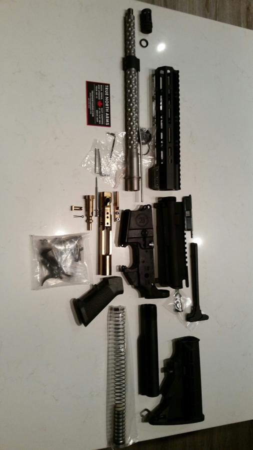

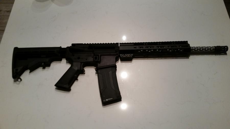

My schedule changed and I managed to get my mystery box today. No assembly yet. Just a mock up. Mag not included. Thanks TNA.
