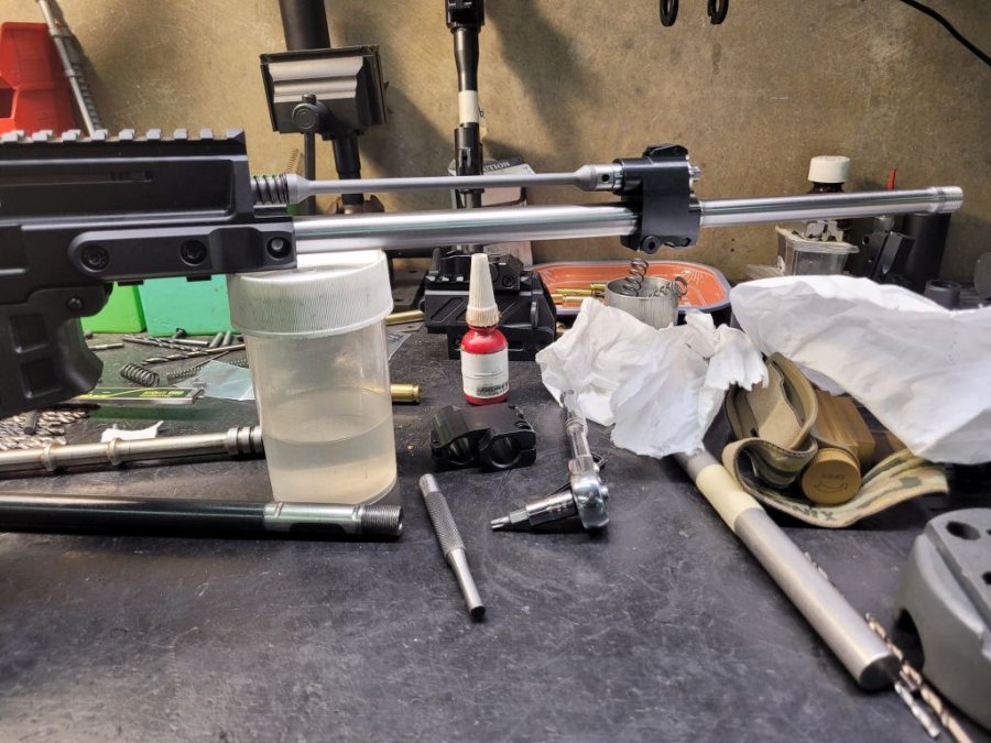

Just finished up the first proto barrel for the 7.62 x 39 rifles with a LONG GAS SYSTEM. As far as I know this is the only long gas 7.62 x 39 you will find and she runs BEAUTIFULLY. I will now focus my attention on chambering the other barrels and getting them out for bluing so we can proceed with these and get them out to you guys asap. Here is a picture of the barrel profile, we went with a CZ-858 front profile exactly to lighten up the front end while still keeping the rear of the barrel a medium to absorb some of the commie heat rolling off these rounds.

Which length rifle was this from?? As far as I know only the 14" x39 rifles still came with the short gas system
These are all the 11 in Brens. We are adding the barrel and selling the guns with two stand alone barrels. The gas system is the same as a long gas system .223
Looks great! Not sure if this was already asked but I am assuming the muzzle is threaded, what is the thread size/pitch? thanks
Yes, the muzzle is threaded to 5/8-24. I was thinking of threading it M14x1 like a good Com Bloc should be but the selection of muzzle devices would then be severely limited.
