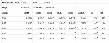

I tried some N555 with some Barnes 145 gr Match Burners on the weekend, as I was intrigued by their high BCs and had gotten some good results from N555 for 6.5 CMs in the past. Used new Lapua brass run through a Cortina .2625 expander mandrel and CCI No. 450 primers. I didn't have data for this load so had to interpolate a bit and therefore started on the lower end. As you can see from the photos (200 yds - or actually 188 yds at Silverdale), the groups were starting to group better as velocity approached 2,600, but I don't think I'll be trying N555 again with these bullets: they are very long and, while I expected that the loads would be compressed, they were really compressed and made seating the bullets a chore. I'm going to try H4350 for another ladder (and have some actual data from Barnes for those loads) and see if I can get some improvement. Bottom line: I would avoid N555 for the long Barnes bullets.
