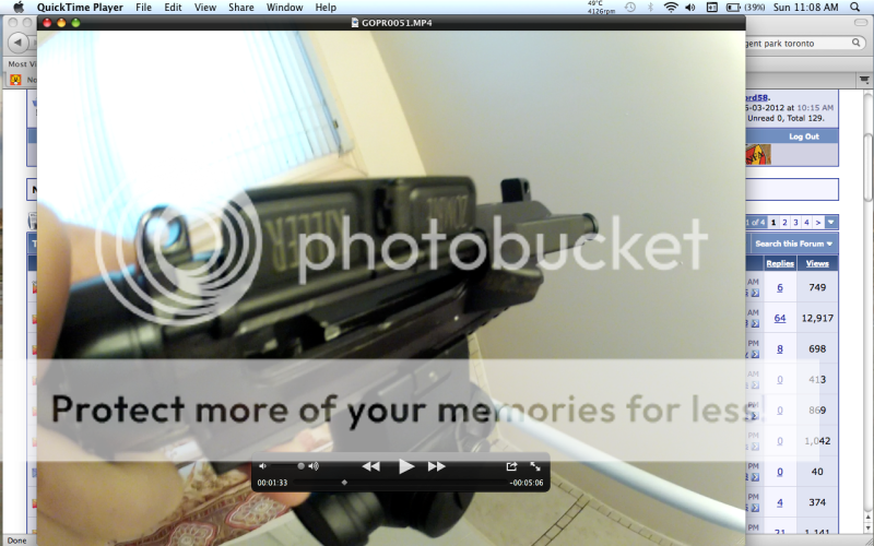

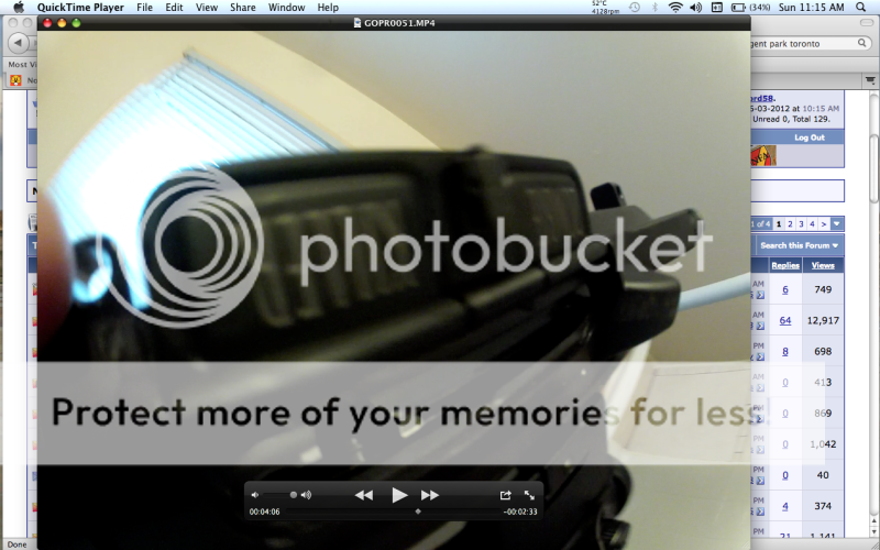

In the picture , it doesn't look like the receiver has very pronounced ramps cut out. On NEA's site they say M4 feed ramps and ramps on barrel extension but
how well has it been done?
As far as an extractor issue, are you getting stove pipes from spent brass??? videos look like she's throwing good.
Not really sure about NEA's firearms.
Stove pipes are spent brass, and the new ejection issue is that the brass isn't flying very far at all.
I'm going to take this to NEA's forum now with some questions.
ya , I'm well aware that stove pipes are spent brass. My point was that it's likely not an ejector problem if you are not getting any pipes!!!
If your ramps look good then I would suspect timing with the gas. Cycling too fast. Old Stoner made the impingement set up for a longer barrel. Shorter and they can in some occasions become quite finicky.
