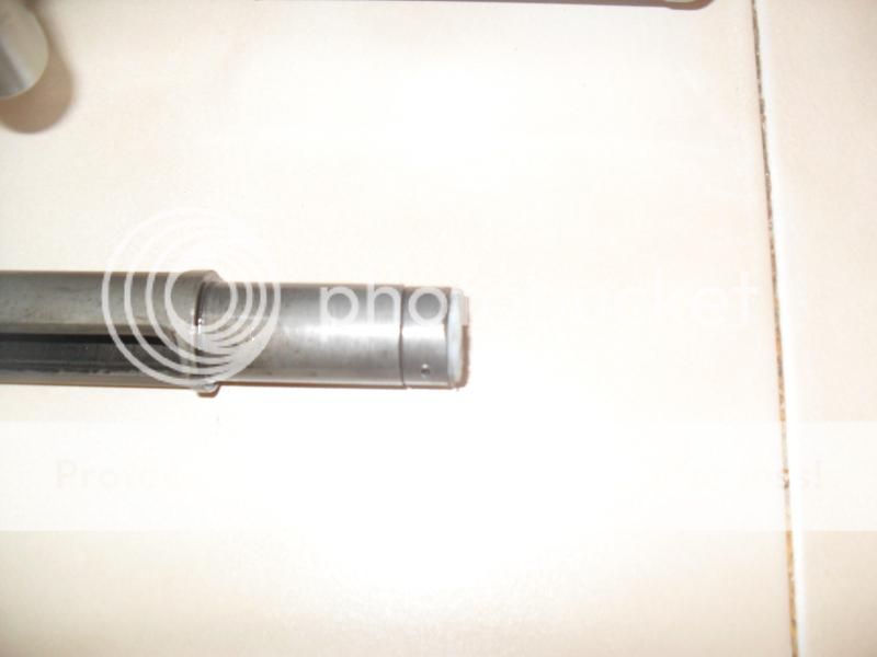

The Good – It appears to be very well made, things fit together near perfectly, the rails slide smoothly, it’s solid. It looked like the inside of the buffer tube thing might have been dry film lubed. The carrier appears good, solid, well staked, the coating feels slick. Overall build quality seems quite good.
The Bad – If I pull my bolt all the way forward in the carrier, which it doesn’t necessarily do manually cycling it, and put it in the lower it almost perfectly lines up with the bolt catch. I have like 1/32” of room. If I put the spring in it binds up and I can’t get the carrier back far enough for it to clear the bolt catch, this is just testing by hand, so once the upper is on I might not have an issue. Now, I have a lower that has a lip on it above the safety, instead of flat walls, and I can’t put the upper and lower together because the carrier sticks out the back. So it won’t necessarily work with just any lower.
The Ugly – Alright, why is every component of it a different color, the parts that appear to be aluminum are 3 different colors. It doesn’t really bother me but common guys. It appears that the end cap on the buffer tube should have been 3/8” shorter as the stock will not lock into its shortest notch. Subsequently, that end cap seems to be made out of steel and appears to be adding a good amount of weight. I would like to know the reason for this as I am seriously considering cutting 3/8” off of it. Finally, the set screw on one of the legs sticks directly out of the side 1/8”, not sure of the reason for this, but it looks like it is asking to be snagged on everything and anything.

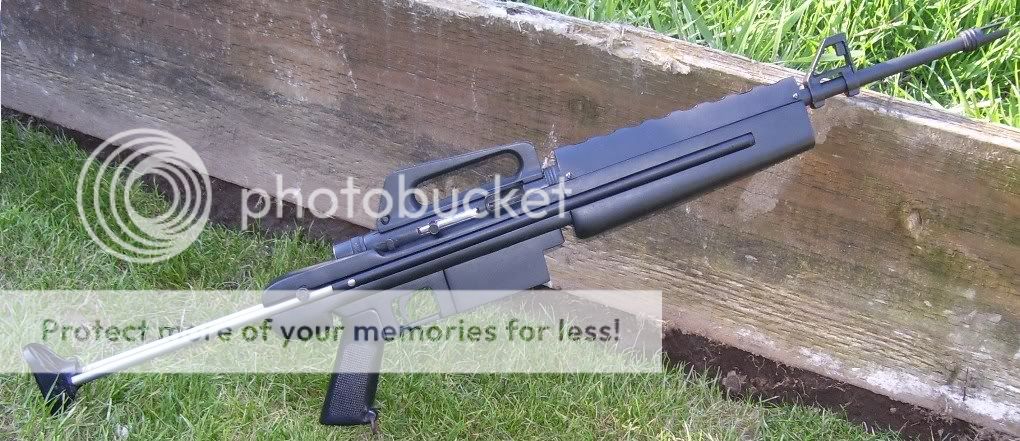

You can see the lip on my receiver here, there is a little aluminum showing from where I forced it together. (Bonus points if you can guess the type of receiver.) I guess the back of my buffer is somewhere between FastFord's pics.
Here is the bolt fitted into the receiver.
