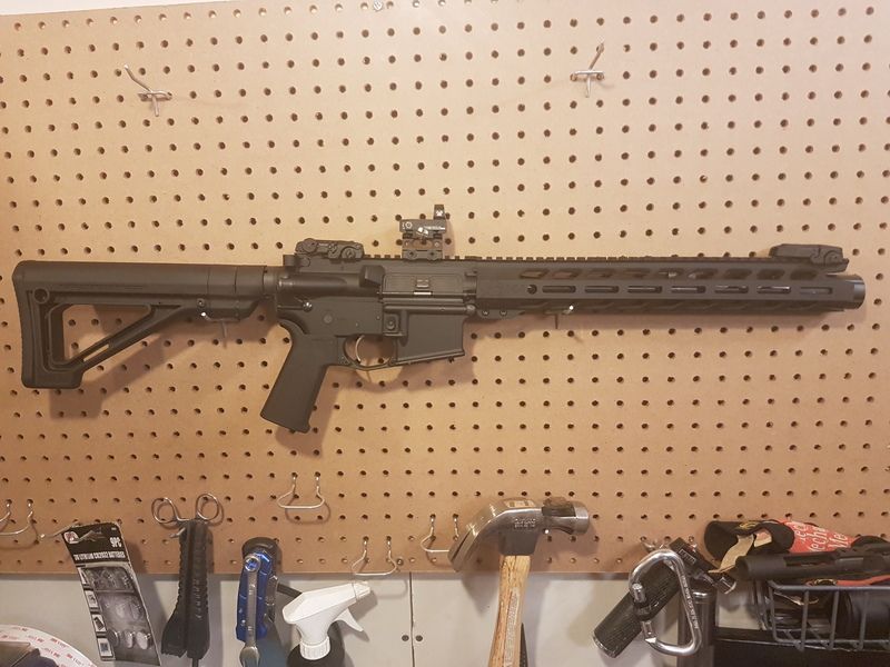

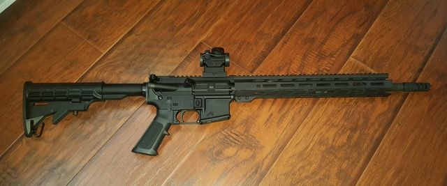

Received my 14" rail today and just got around to installing it on my M&P15. Wasn't hard to twist on at all luckily. For those interested, it weighs in at 10.7oz. My rifle just lost weight going from a 7" quad rail to a 14" rail... who would of thought.
Received my 14" rail today and just got around to installing it on my M&P15. Wasn't hard to twist on at all luckily, only had to file down the side receiver retaining tab just a smidgen for the two top rails to align properly. Absolutely love it. For those interested, it weighs in at 10.7oz. My rifle just lost weight going from a 7" quad rail to a 14" rail... who would of thought.
That looks pretty. How is the black finish? Is it like the earlier NEA purple/gray receivers or true black?
