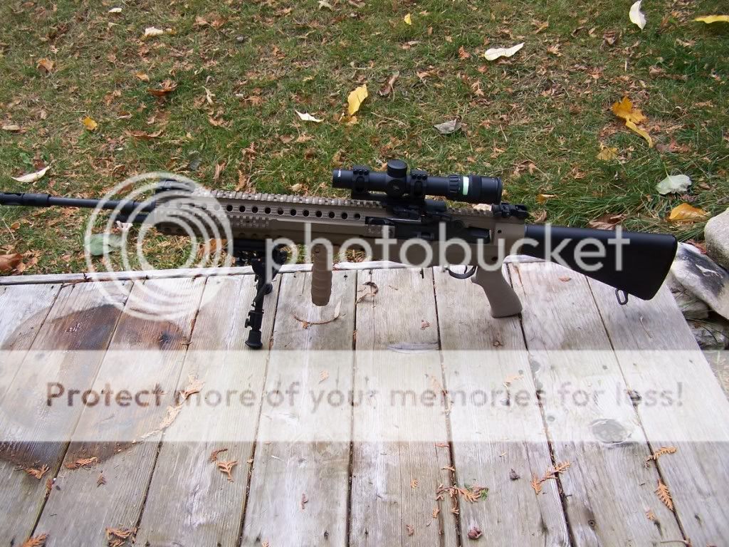

Jeff at IMA was kind enough to send me one of their new oversized M14 mag releases to try out so I thought I would post some photos and provide a little review for anyone thinking of this upgrade. (rifle is a 2009 Polytech in a Troy MCS stock)

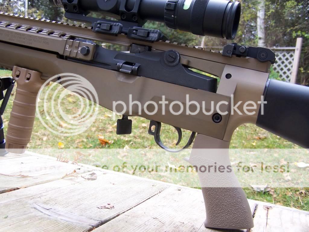

Now that that's out of the way, lets talk about build quality. It's excellent. This is clearly a CNC machined part. It is made of hardened stainless steel and blacked commercially. You will note the horrible degree if fit and finish on the Chinese part by comparison.
Also note that the Chinese (and USGI) releases are slightly curved - this is to get the release farther from the mag to increase leverage, while the NEA release has a straight face. The curve is not necessary on the NEA part as the larger radius provides plenty of leverage and the linear smooth face seems to make mag changes slicker as you slide the mag up along the face of the release, guiding it into the magwell. If you have a reasonably long index finger, you could operate the release with the grip hand, though due to the M14 design, the mag still won't drop completely free, but it will speed up changes slightly.
The back of the paddle is serrated but not so roughly as to irritate the pad of the thumb when using it. It is also slightly wider than the width of a magazine, which really takes the guess work out of fast or blind mag changes. The tolerances were tight enough that I can not notice any binding issues due to the thumb pressure not being in line with the centre of the magazine. It is also ambidextrous, though since I am left handed the photos will reflect that.

Having tried both, I personally prefer the NEA release much more. It is easier to find without looking down and the serrations are horizontal as opposed to the vertical serrations on the sadlak. With my hand positioning, the horizontal serrations provide a more positive purchase on my the thumb pad. Checkering might be even batter, but no checkered releases are yet available that I know of.
If you do anything with your M14 where fast reliable mag changes are required, I give this product a very strong two thumbs up. The build quality difference alone is almost enough to justify the upgrade over the stock chinese part.
I timed myself doing rapid mag changes with both release types on the same rifle and by my calculations I'm about 10% faster with the NEA release.
