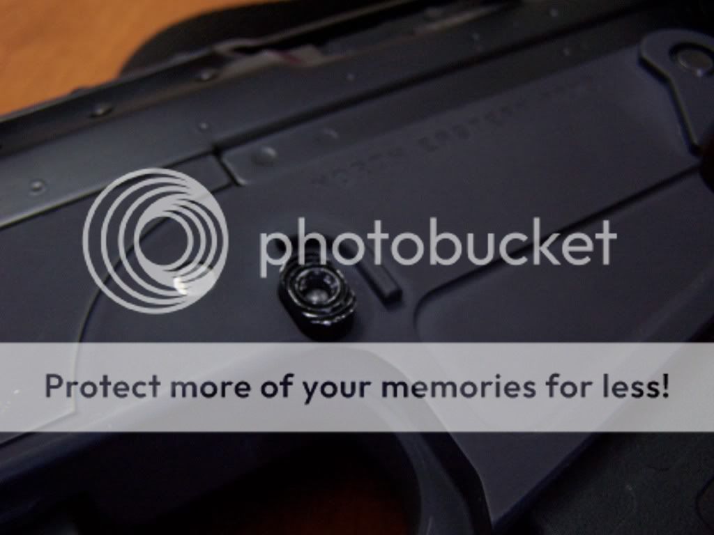

I then proceeded to install the parts I did have on hand. I had a 5 position, mil spec, Vltor buffer tube as well as a Colt castle nut and index plate. These parts fit fine and there were no issues. However, when I moved on to installing the AR magazine release I found that because of the thickness of the lower in comparison to an AR lower (which the part was designed for), it proved slightly difficult to install. When I did get it properly installed, I noticed there was barely any button protruding. This is slightly troubling. On the flip side, the catch is so recessed that I seriously wonder the ability to use an ambi-catch such as the Norigon. Admittedly, I do not have one here to test but to my eyes it may not work correctly.
Magazine Catch Correctly Installed (end of the shank is flush with the button)
Left Side Magazine Catch (deeply recessed into receiver)
Comparison with an AR lower (showing button protrusion and color difference)
I ended up backing the catch out one full turn to get a little more button showing. Kinda hokey, and I'm not totally happy with this solution. I may have to fabricate a catch with a longer shank on it or perhaps a longer button. It should be noted that an AR catch does not need to move a whole lot to release the magazine and this one did function, despite it's limited travel. I would have just liked a little more of a positive button to push.

On the mag catch you can back it off a few more turns. There is no reason why it cant be done that way. Its being used that way by LEO in Europe and not been an issue.

The mag catch can definitely come out a few turns, they have adjusability to do this and by your pics it looks like you have yours screwed in pretty tight. I am considering one of these so please keep us updated.

OK .. About the mag release.. I think I'm seeing it now. In those pics the receiver looks much wider than the AR. The mag catch would have to be spun out a few turns to make up for that or maybe a specific one made for it.
In the photo comparing the NEA lower next to an AR lower, the button on the mag release is already spun out one rotation. You can only turn the mag catch eight rotations before it unthreads itself and in order to mimic the AR's mag button depth, you would need to unthread it five rotations. Will it work, yes. Is it ideal, no.
I have settled on spinning it out two rotations. This seems to provide enough button to easily locate with gloved hands and enough travel to reliably release the magazine. Rotating it out anymore then this will completely negate the small mag release fence in front of the button. Laying a rifle on it's side should not cause the magazine to release. If it does, the fence or guard should be raised.

Most of the 'cosmetic' stuff is hidden internally anyways, although IMHO I think an extended "thicker" mag release button may be something to look into making :)
One thing to consider, is milling the area around the mag release button (if there is enough wall thickness) might be good, and if you extended it into the trigger guard, it would create a nice little niche for your finger to find the mag release button :D

I agree with this idea. So far....
- Mill out a contoured recess for the mag release button to live in.
