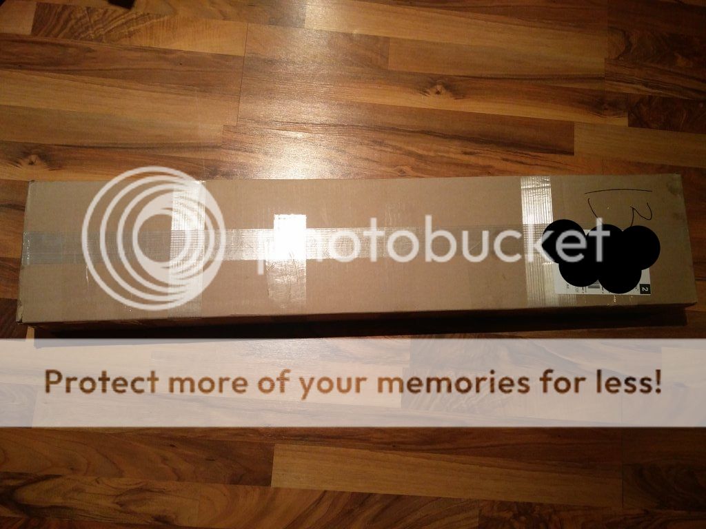

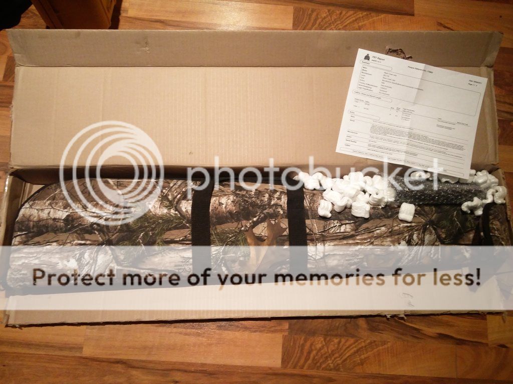

This is the aesthetically appealing, securely wrapped package was waiting for me to tear into her and reveal what was underneath.

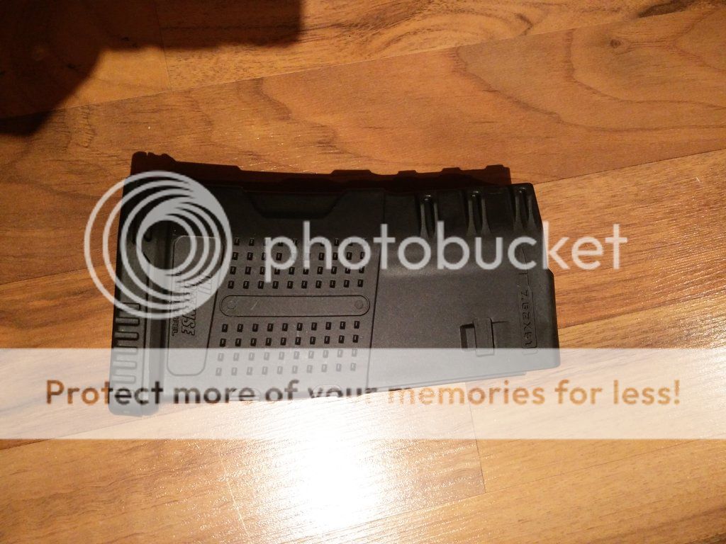

When i opened her up i was pleasantly surprised to see her wrapped in a cloth hunting bag for protection. Also included in the box is the IMI 20rnd Mag , Sticker of a forum not to be named (Not pictured) and the RCMP FRT Report. Thanks for the FRT Printout i'm going to be making copies of this for all my bags because....you never know. The Mag seems to be very good quality and i will probably be purchasing a lot more of these if everything turns out to work good.

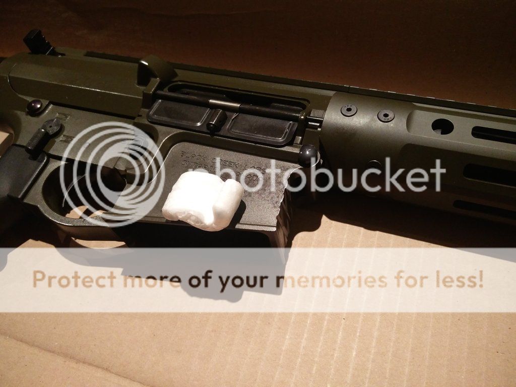

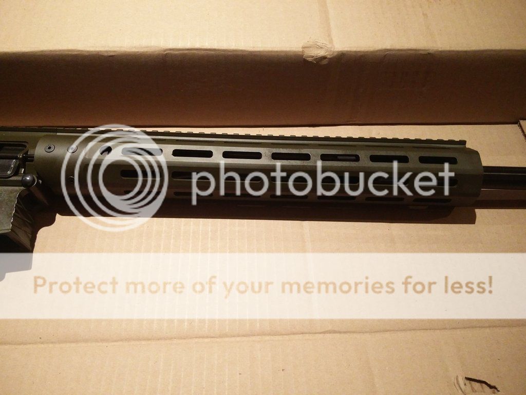

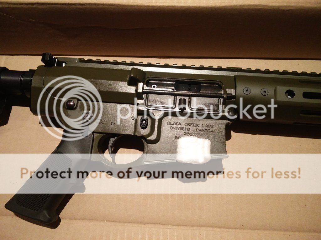

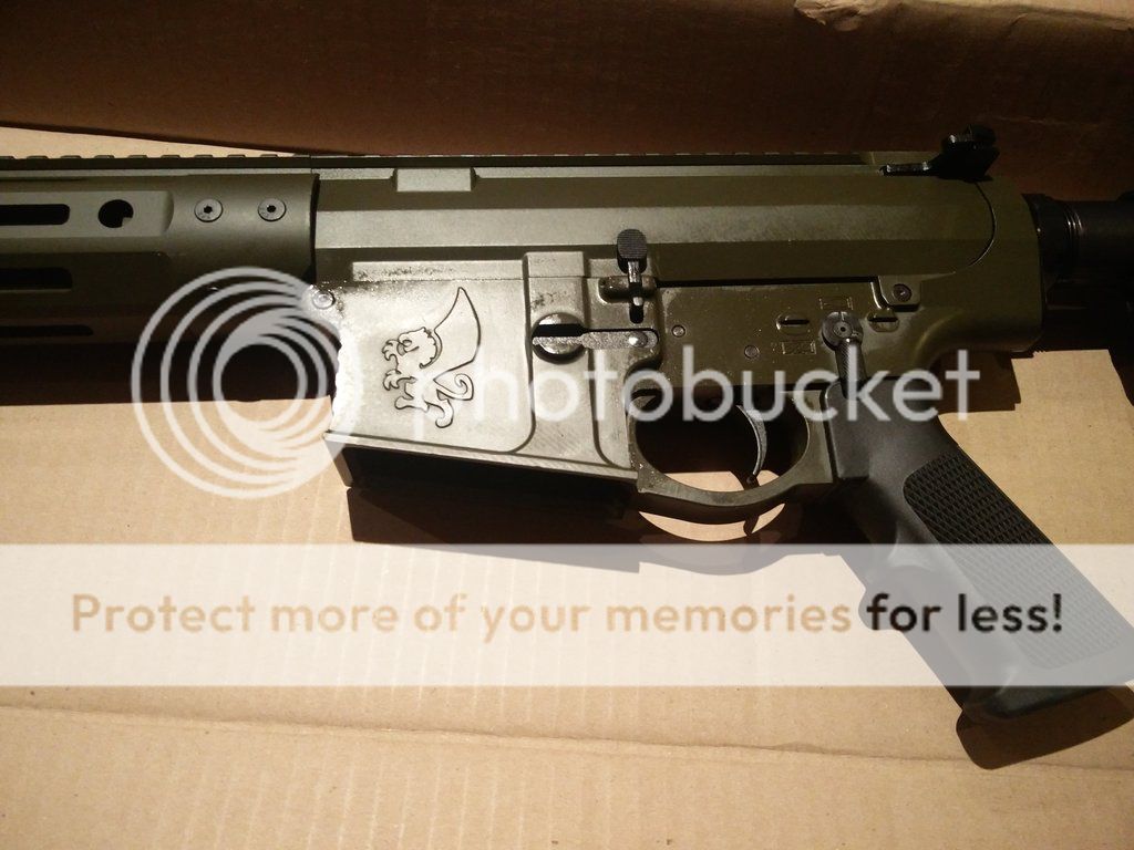

HERE SHE IS!!!!!!! Finally the box comes off! and here she is in all her oily glory!! My first impressions of this......WOW! i am very very impressed. I cannot believe i finally after so much waiting she is finally here. The fit on the upper/lower is supper tight! The only gripe i have so far with this is the charging handle seems a bit small, However i will get that fixed and install a raptor charging handle. Next i will be looking at the lower receiver.

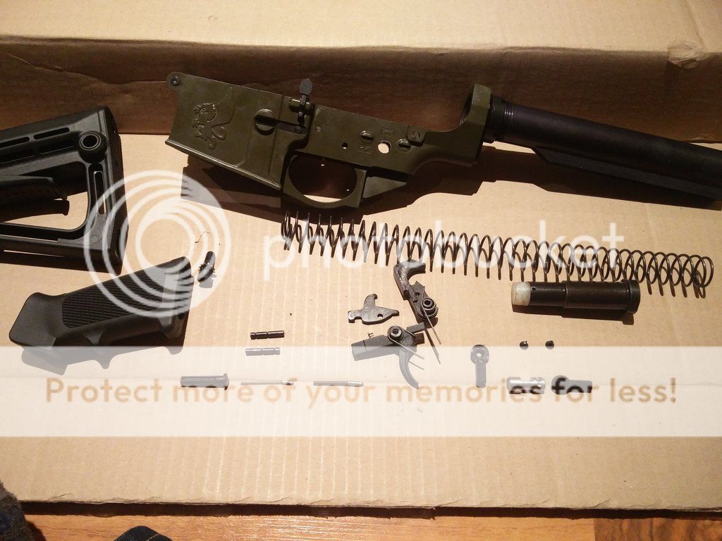

Alright, On to the good stuff. So far everything seems to be supersized AR style. I will be showing the Lower first, stripped and bare for all to see!

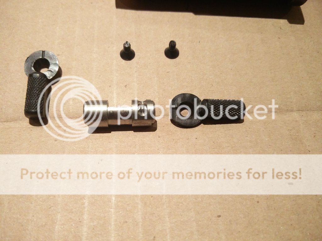

The 102 came with a very nice ambi safety made of metal, it does not feel cheap and has very good actuation, however it is missing not notable click.

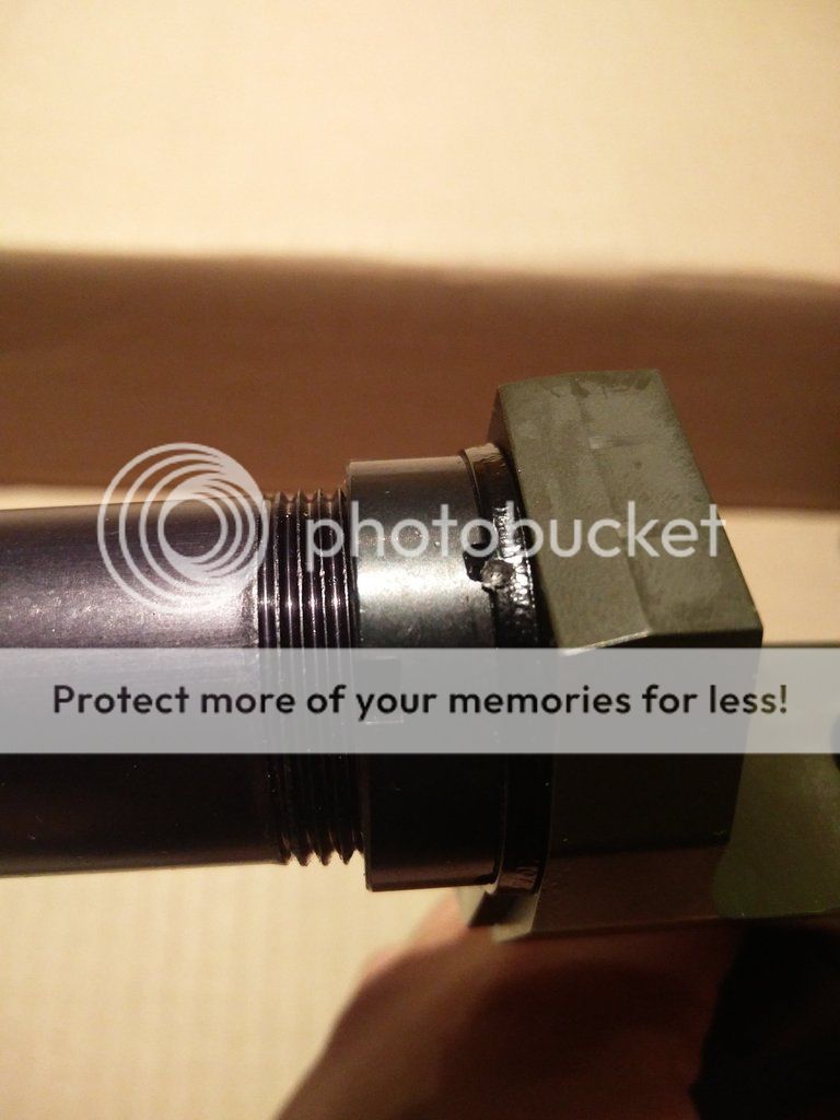

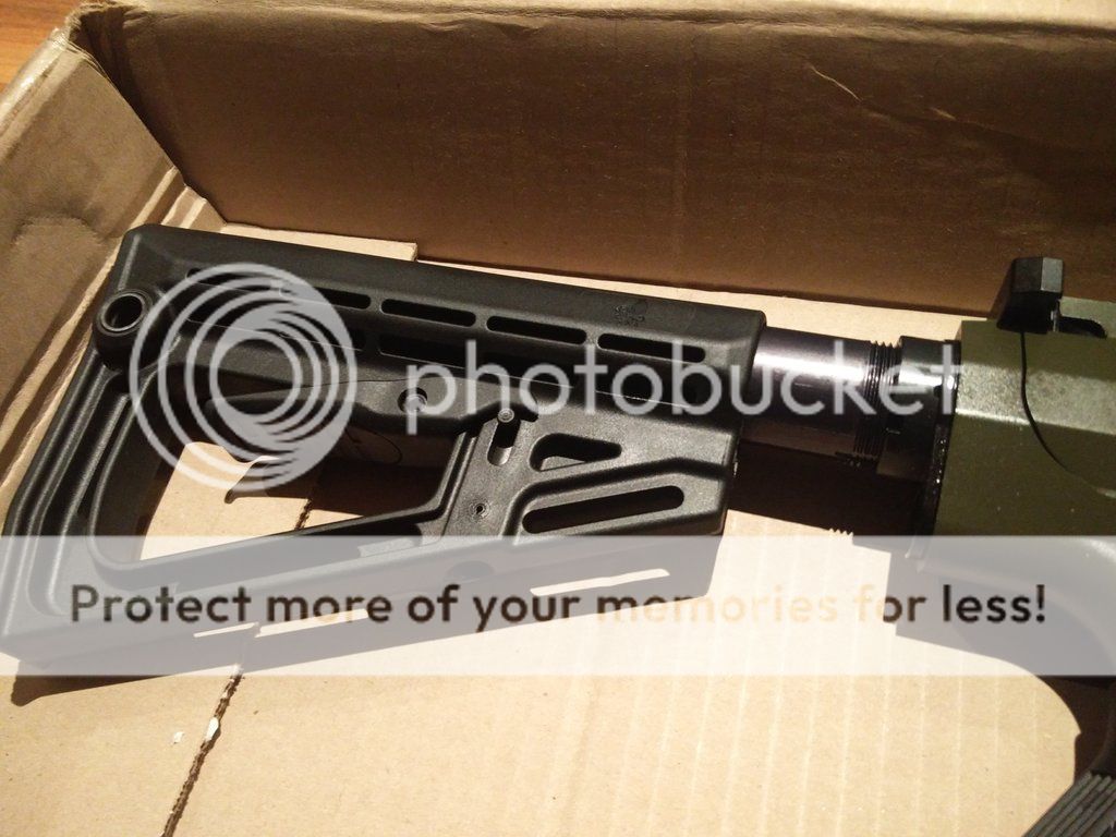

Next up is the buffer tube...now.. i didn't want to take this off and test another as it was so nicely staked. I will remove this when i need to change out the buffer tube and stock. Here is the picture of the stake job for reference in case you are looking at purchasing. Also, important to note the tube is a purplish colour due to the anodizing process.

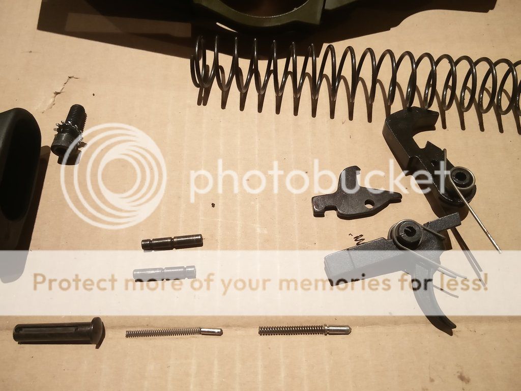

Up next we have the trigger group and pins for the safety and take down pin, this looks very promising as it may be compatible with other AR10 triggers. This will really help as the current trigger in the 102 is very gritty and mil-spec like. This is not a complaint as most triggers for this application are typically like this. Don't get me wrong! for what it is, its very good. its defiantly not a norinco!

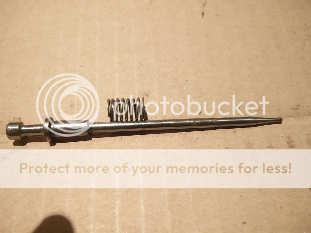

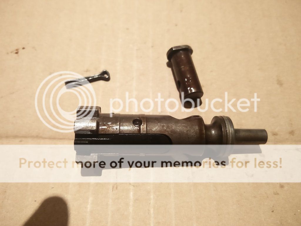

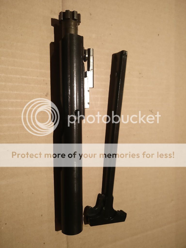

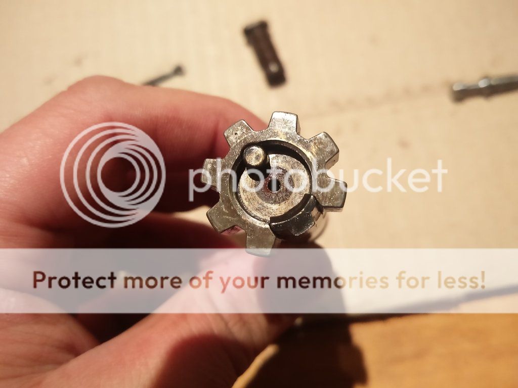

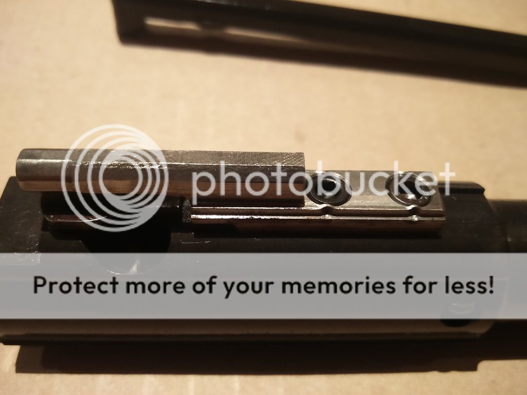

Now, lets get to the bolt! This has very much been a topic for controversy and no one still knows if we can interchange them with AR10/108 bolts. I will use my micrometer and calipers some time this week to measure everything against a AR10 bolt drawing. Would also like to get an extra extractor just in case. Now, below are some money shots! I'm not sure if the firing pin on the AR10 usually have springs however this is a very good idea and should stop any slam fire. The bolt looks like it has some residue from factory test fire, looks like Barnaul or MFS with a red sealant.

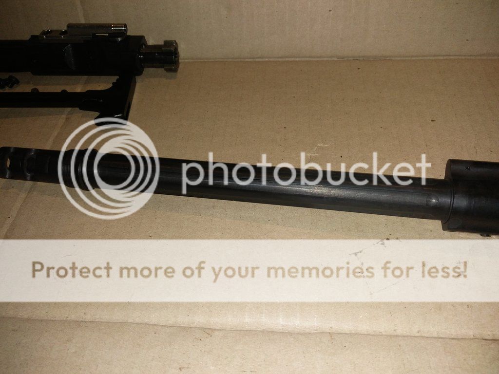

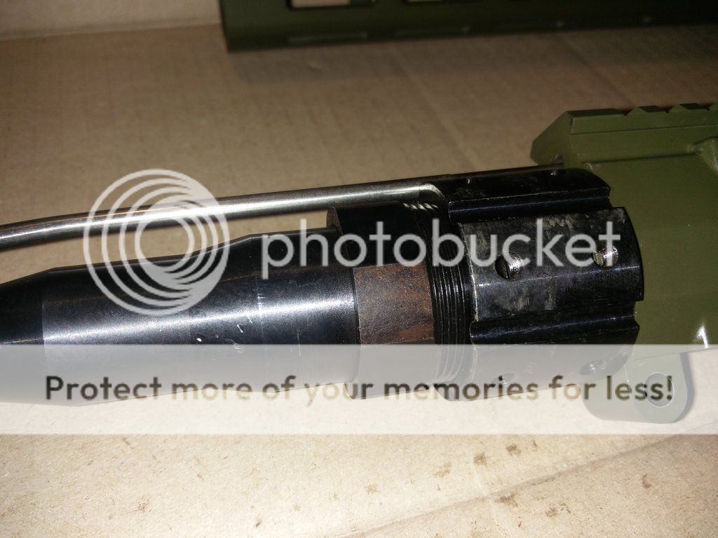

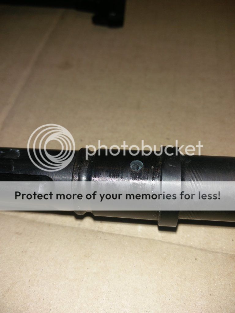

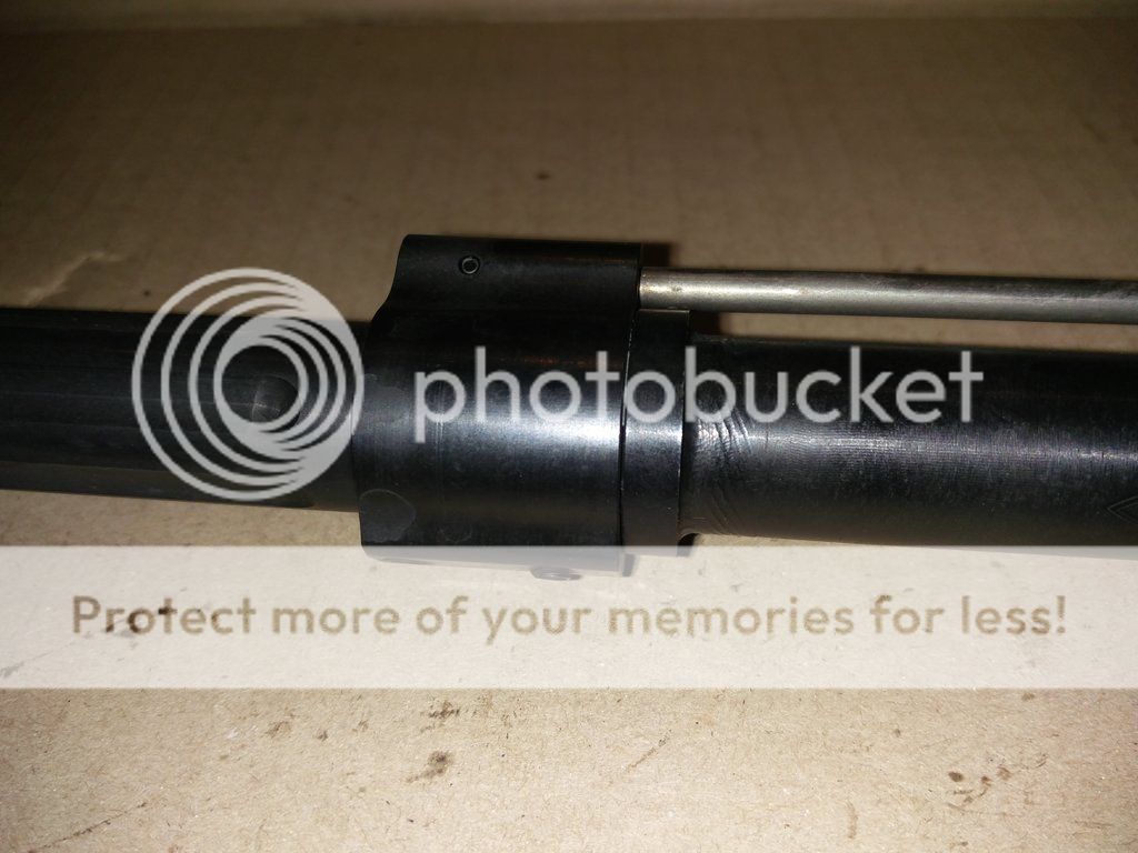

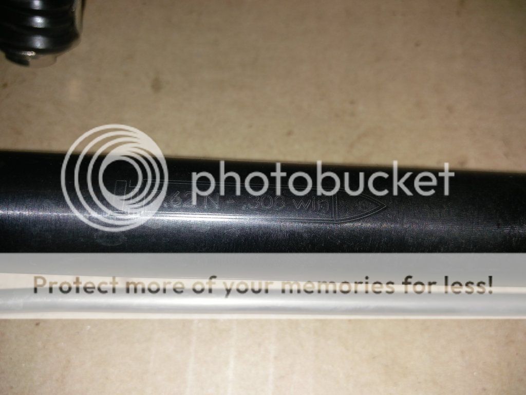

Ok guys, now like i said, i was unable to take the barrel off. So here are some pictures of the barrel and nut. Its too bad that i was unable to take off the barrel nut because as everyone wants to know what its compatible with. As you can see the gas block picture there is definitely some chatter marks on the barrel it looks like this was done before the nitrite process which for me is not a big deal. This is something i'm not going to worry about because if it turns out we can swap barrels, i will most likely swap it out with a target medium barrel. The last picture is when i took off the gas block, you can see by the gas residue the gas block hole is much bigger than the port, this will allow better flow and probably better reliability.
*Update - Glas block size needed is a .875*
