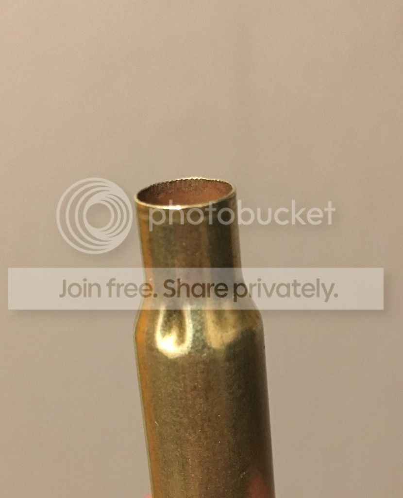

I had a similar question about a casing. I overdid it with this one when resizing, and she buckled around edges. Obviously it's only one piece, so I'd toss it in a heart beat, but I'm still curious from a "common practice" sort of side of things.
Would you reload this?
I load those dented cases. It is caused by too much lube on the shoulder. It is nothing. I have seen factory ammo with much worse defects.
It will have zero effect on the fired shot and will iron out from the pressure of shooting.
BTW, your case mouth needs to be champfered.
Thanks!!
