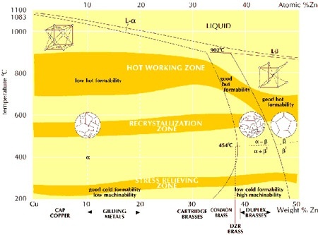

When brass is heated to a certain temperature it softens at a certain rate. Raise it to a higher temperature and is softens at an even faster rate.
So annealing brass occurs as a result of a fixed recipe consisting of a certain target temperature for a certain amount of time.
That time and temperature combination does not know how hard or soft the brass is when you perform it.
If the brass 'A' is already soft, it will get even softer.
If brass 'B' is hard, it will get softer, but not as soft as 'A'.
The brass does not know how soft you want it to get. It only gets softer relative to how hard or soft it was before you anneal in reaction to the time at temperature.
