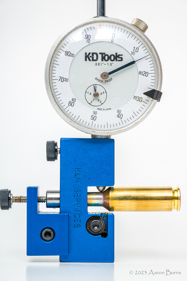

So moving to 6mm GT from 308 is turning out to be an adventure all unto its own.
For context, I've turned a lot of brass, mostly Lapua 223 and 308, and mostly just skimming to remove high spots, but also a lot of tight-chambered 6mm PPC. This Alpha 6mm GT brass has presented a new challenge, and before I accost the Alpha people, perhaps the collective wisdom of this forum can help.
The new challenge is tapered neck thickness. The necks start at .013" or less near the mouth and thickens to .014 or a bit more near the shoulder/neck junction. I'm reluctant to turn it all down to .013, because that means a finished OD of .269 and the SAAMI spec is .273, which in theory works the brass a fair bit with each firing - but I'm not an expert on how much free play in the neck is too much. On the other hand, turning it to max .014 - just skimming near the shoulder - makes it .013 near the mouth and .014 near the shoulder, so a .001 taper in the neck tension, which can't be a good thing.
Pics below.
Thoughts? Should I turn it to .013? Should I complain to Alpha and get new brass (given that I'm in Canada and this could take weeks or months or longer)? For all I know a tapered neck isn't terribly out of the ordinary, but I think it is.
Thanks in advance!
Sequence showing neck thickness - notice it goes from just over .012 to a solid .014:
Results of turning to about .0138":

1) thanks, I may try cutting a bit deeper to even out the neck tension
2) It is! I have enjoyed using the K&M for years - it cuts cleanly and is very easy to adjust. And re: pictures, this is my eBay photo setup repurposed :)

1) Thanks Jerry. I'm starting to realize that current thinking about neck clearance is looser than I'm used to. I'll measure the reamer later (got it a couple of days ago), but the real data will be available when the barrel comes back in a good many weeks and I do a chamber cast. I was hoping to do all the brass prep before then, now thinking perhaps I should wait for that cast.
2) in the pictures, would you say I was a bit deep into the shoulder? Not sure, I typically cut less deeply, but I'll listen to your advice given your track record :)
