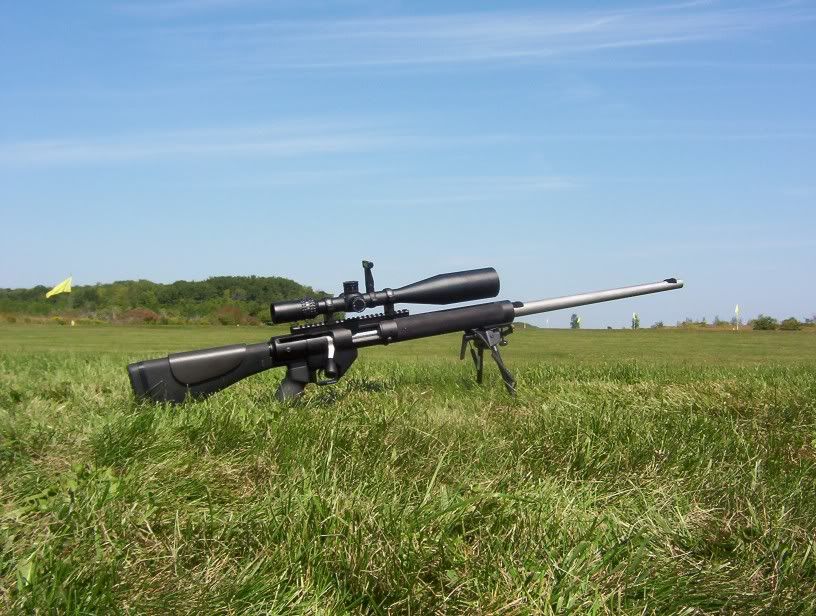

An Idea for a Non traditional pole
Rem700 SA trued (davidson ss plug)
Factory trigger tuned 1.2 lbs
30" McLennan 6.5 1n8 heavy palma taper
Chamber in 260AI Imp
MAK single shot Tube gun kit(includes 20 moa rail)
A1 butstock with 3 way adj pad
SPR grip
Redding 3 die set
RP brass ok requires fireforming (easy )
This was the first of a few of the tube guns I have built and I kept it reasonable investment for the first go.
Been shooting this caliber since back when it was known as a 6.5/308 Ackley Improved and like Mystic's 6.5 have tweeked it some over the years.It'll run
142SMK's at 2950FPS and plus if wanted with under 10fps ES and can do everything a 6.5/284 will do with less powder/less heat/less recoil (very efficient and scary accurate to 1000)
Only thing you need the smith to do is chamber and fit barrel and ensure action is trued.Assembly is a fairly easy DIY job with a bit of Devcon or JB weld.
My Later models have been built off of PGW M15 action and Barnard actions but Rem 700's work well.(The Tube sleeves the action increases it's strength and stiffness of the 700 for holding heavy barrels.
Kevin at MAK also makes repeaters and is working on 1.a Savage Kit and 2. a long action Kit.
This is set up as switch barrel gun (very easy) and also can switch buttocks and forends (squared , vented tubes ect ) for different applications.
Easy to convert target style set up to a shorter lighter hunting setup in minutes..
The latest version is a take down rifle, has 3 different buttocks ,2 bolts (308 and wsm faces)
2 trigger systems 4 different forends and 2 different pistol grips plus a recoil management system and 4 barrels 3 calibers with one more on the way.
You can modify your shooting system easily and add to or change as $ or needs dictate.
When you build it you can make it the way you dream it.
Define the purpose,design the gun and build your solution.
Just a thought for under some new gun prices
