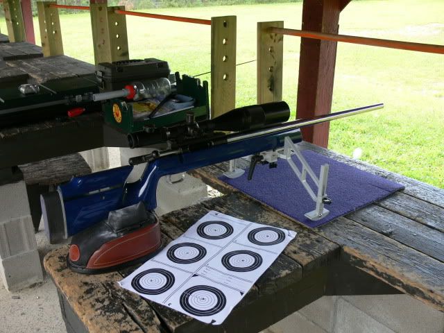

Mark save your money and get one made similar to one of these.
The blue one will shoot 69gr,80gr, & 90gr Sierra,s and Bergers under.250"
I have been there with manufactured rifles the barrels are to short for F Class at 1000y in FTR class can,t get enough speed, and chambers are to short for the 90gr bullets. That target was a 50 4x the sighter was a x
This Green one is a Rem 40x action and 28" Hart, on a new Robertson thumbhole stock I have seen this gun shoot 3 5 shot groups at 300 y
.600" ,.617" & .678" and a 5 shot group at 100 just under .2"
You can build one of these under $3000 + scope, build time app: 8 to 10 weeks
