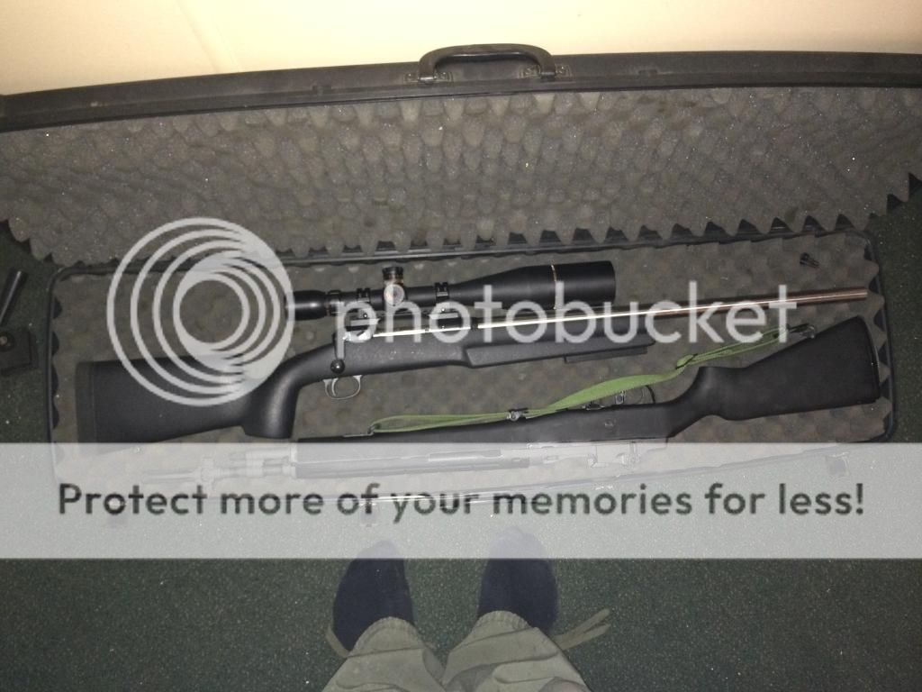

....like this?
Shilen select match HV contour 1-8 twist 7-08 tube on a 11 receiver, RB trigger and B&C Medalist stock, 25MOA KF steel rail with an 8-32x56 LRMOA Siii to cap it off...
Shoots weeeee lil holes with 162gr Amax's over H4350 all day...
Gets kinda boring actually.
