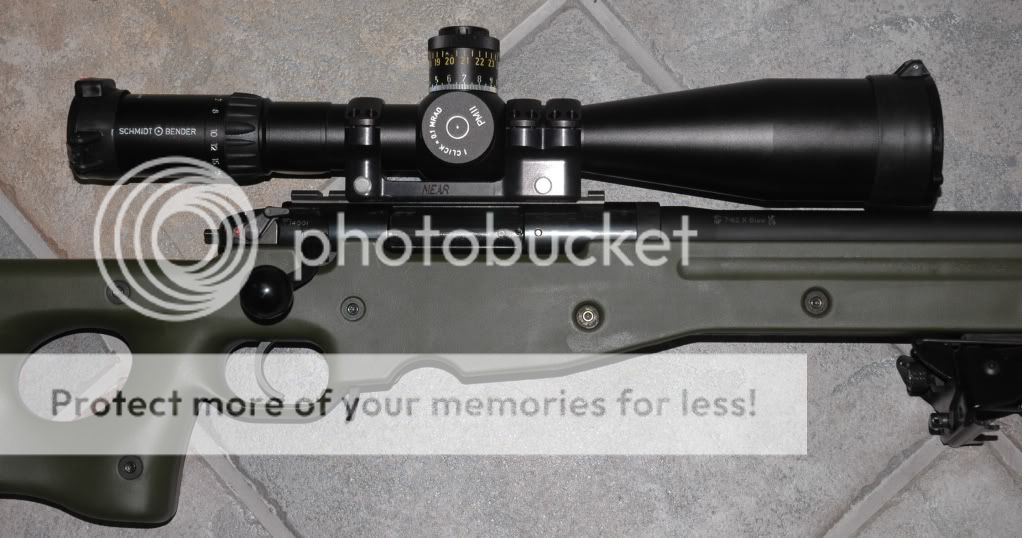

What rifle are you trying to put this on??
A Steyr SSG 08

Good for you, but where are the pics you promised!?!?! I was expecting an update to your thread in the "Precision rifles" forum!
p.s. That mount was practically made for the S&B; if you read the manual for the latter, they specify that you get a mount that's canted to half of the elevation range. Guess what the elevation range is for most S&B's with MOA elevation increments
Premier Reticles looks like a quality choice as well. Looking forward to your updates!
What makes you like the Near Unimount more?

The AI has 3 small allen head screws to clamp. The NEAR uses the standard ( ie, like Badger, TPS, Leupold etc ) 1/2 nut . I have a torque wrench with 1/2 socket in my kit for all my other rifles
Overall build quality and beefiness is much higher ( even a NF Unimount is beefier than the AI ..but not available in 34MM )
Most annoying with the AI is the corners are sharp. My AI kept getting caught on my jacket when I had the gun slung on my jacket . If you are not packing the rifle for days on end hunting I guess this would not matter.The NEAR has large radius
Lastly , its Canadian made
They have a 28MOA 34MM in stock right now BTW
