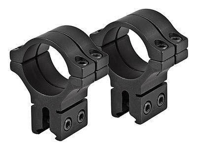

BKL 301 rings are double strap rings that are sufficiently high; BKL 300 are single strap rings. Both are 0.979" to the bottom of the scope tube. The double strap rings are shown below.
