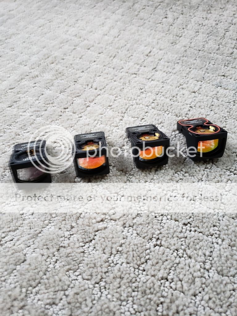

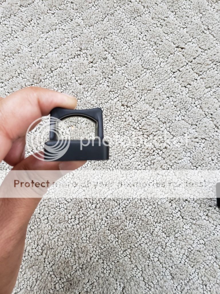

So I recently purchased an rmr off the ee and I'm pretty sure it's a fake. The seller claims he got it from his local gun store and it's real. Compared to my other 3 RMRs I find some signs. I took some pics compared to a real rmr01. I'm just wondering if you guys think it maybe take as well?

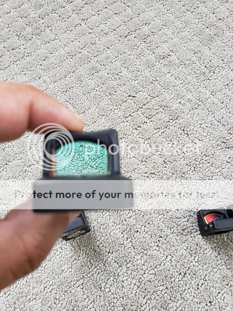

The glass is clear no tint of blue.

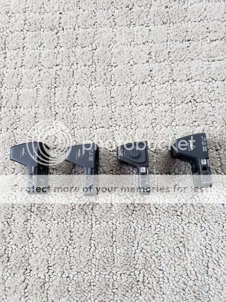

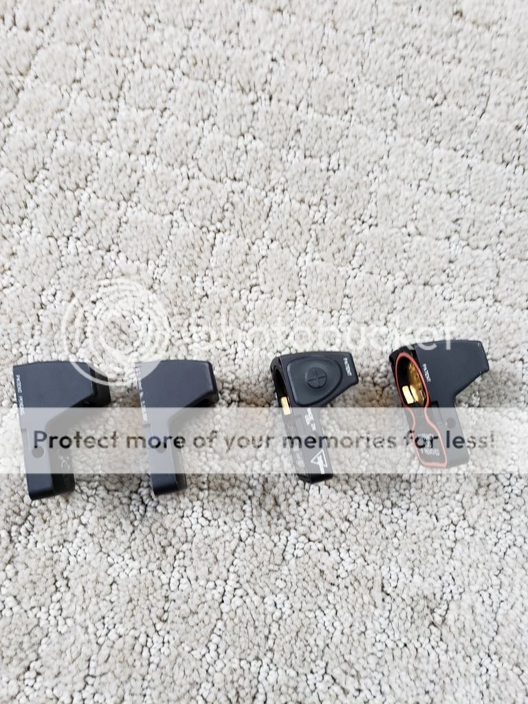

The patent markings etc are similar but slightly off.

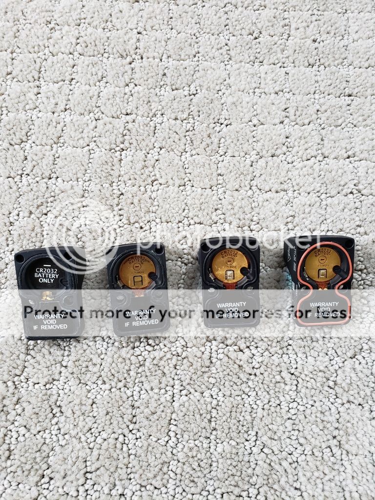

The battery compartment is different. It's magnetic to hold in the battery instead of the prongs. The backing is black instead of gold with no mention of dot size.

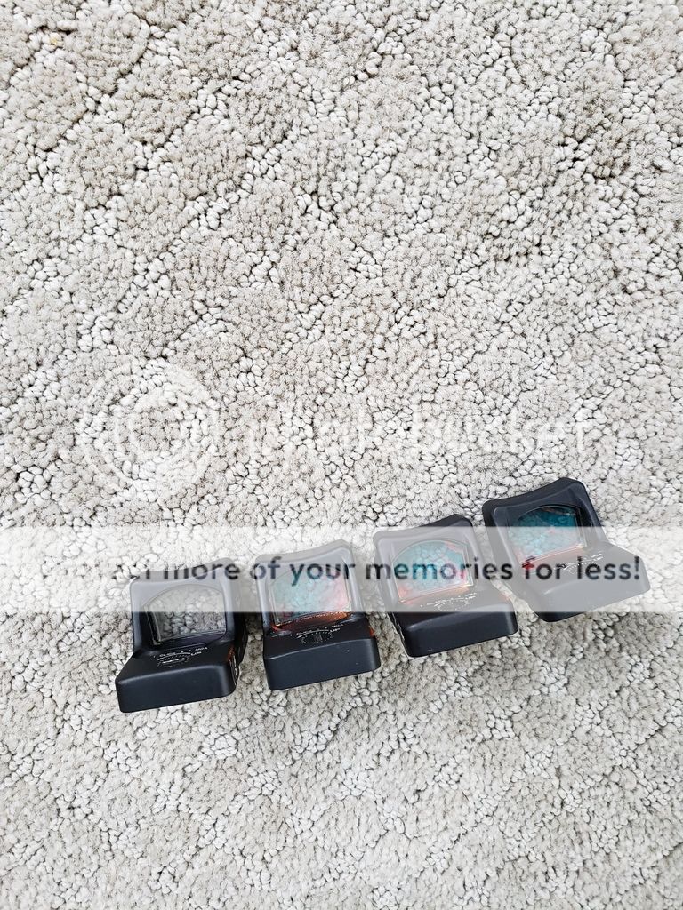

The dot seems a little weak and off colour.
