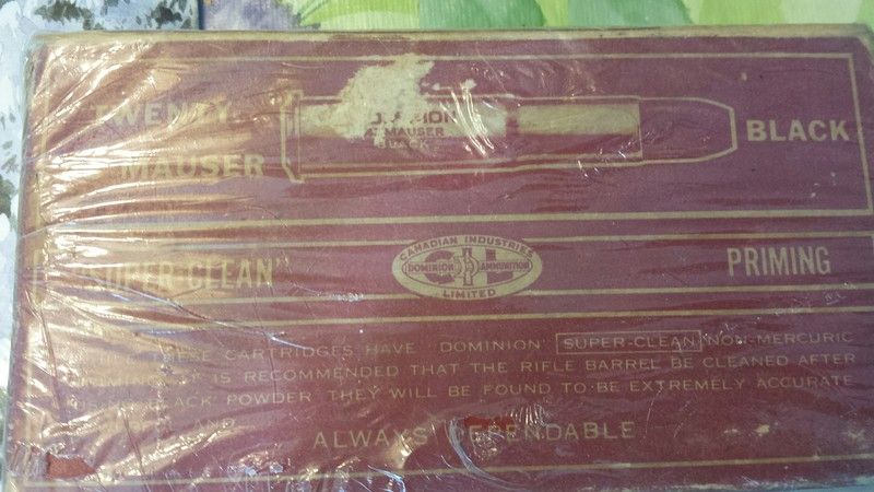

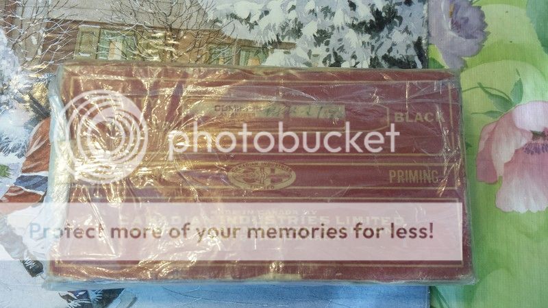

They go for $100-$120 /box in the US, don't know what you could get for them here. I saw some for $100/box at a gunshow last spring in Edmonton, don't know if he sold them though.
