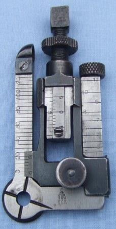

Heres a picture for reference of the volley sight aperture that you're missing.

Problem with photos of the Sight is that you have to FIND on before you can photograph it!
"If wishes were horses, Beggars would ride......" and I don't have one to photograph!
This is the easiest one for general use, if you can find one. Have to be careful not a knock it around though.
