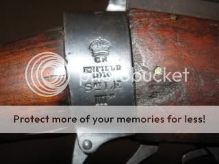

made by Enfield, in 1916, serial number D with 4 digits

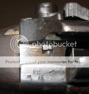

Left side of receiver is marked BNP

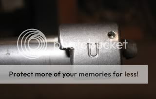

Bolt head is stamped U

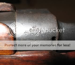

It sounds like it's wearing Australian coachwood. We'd need to see pics to determine if someone put that wood on it to restore a sporter, or if it's an australian refurbishment of a British rifle, which is also very possible.

BNP marking is post 1956 civilian proof (Birmingham Nitro Proof) as British law requires all arms to be proofed before public sale. So most likely it was surplused and proofed for Brit market sometime after then.

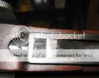

HV tells me that sights have been setup for High Velocity ammo (Mk.VII cartridge). So should be sighted well enough for current day commercial ammo. Every rifle seems to shoot off a bit, you have to get to know how it shoots and compensate by aiming English style (ie aiming off).
U on the bolt refers to the grade of steel from which it is made, I believe.
Cocking piece is a replacement as it appears to have BSA inspector's stamp.

Need to see right side of receiver and under the handguard to see the barrel nocks form to tell if barrel has been replaced. The original barrel and receiver were numbered with the same roll die at the factory so should be identical. If the font of the characters or the spacings of the two numbers differ, then is likely a replacement.
Not a rare specimin by any stretch of the imagination, but is a nice example of war time production ( its a Mk.III*). If the bore is nice, then it would be worth restoring with nice wood. But be warned, you might spend two hundred dollars on it and end up with a three hundred dollar rifle.
That gun looks to be a "restored sporter". It has an Australian forestock, but the metal has no Australian markings such as a MA ftr date. I'm sure it's still a ncie representative axample though - you should try shooting it a bit, see if you like it :)
