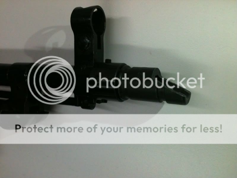

I have one on my fsn and noticed a big difference. The recoil was much more crisp and hard on the cheek! Fast firing yes it would recoil down. Also u will have to re-zero your rifle. Before I put it on, had it zero at 100yrds, put it on and (depending if a left or right hand shooter) mine shot 16-18" high to the right. Tho it looks awesome and will keep muzzle climb down, im not a fan. Only advantage I see is cosmetic looks and good for rapid firing. JMO.

Well, of course it change POI. Just adjust the sight. Regarding recoil into your cheek, the slant should not be horisontal, slightly down on right side. I am talking from my own expiriense, I have the sks with slant muzzle brake and it works. Anyone in Vancouver are welcome to try it at PoCo range.

How exactly does it work? unless your SKS is full auto no it does not work . The slant break was built for one purpose only preventing muzzle rise on full auto fire on AKMs and the design was dropped in later models for a ported break . After market slant breaks for non AKM rifles are just a gimmick. Dont waste your money on these people get normal ported break that really does make recoil better .
