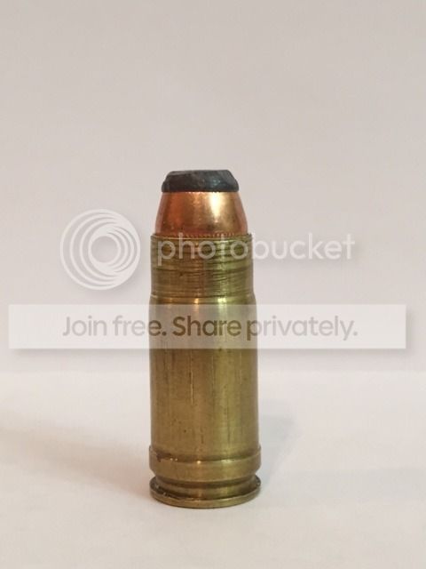

need some help identifying this 44 wildcat
yodave
448   0   0
I got 73 loaded rounds in a box last year at a gun show as well as a bunch of fired cases, here is what I know....
.44 bullet (.429) in a heavily modified 7mm Remington magnum case, case was trimmed to 1.215 inches long........so what is it??? I have enough loaded ammo hear that a new barrel might be in order, although these are kind of fun to leave lying around the different ranges I shoot on............
[/URL][/IMG] Sometimes we just Have to play and it is a one of a kind. The one above is a sample of this, it is called a 338 Dean, designed to shoot a 300gr bullet at 1050ft per sec. I also started with a 7mm Rem Mag case, but any belted Mag case will do...If you want your 44 wildcat, send 3 fired cases to PTG and have them make you a reamer, The only limit is your imagination and your budget....Have fun with it!
