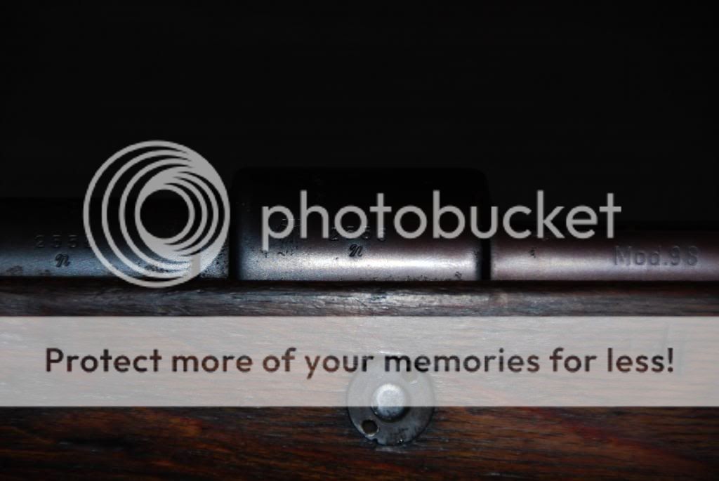

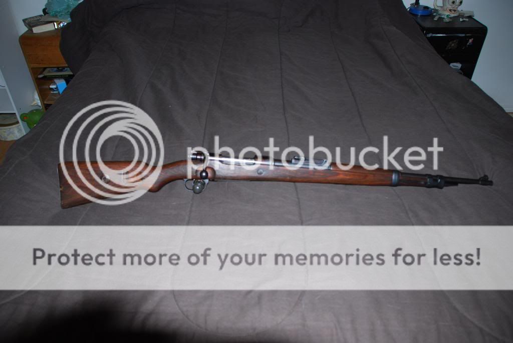

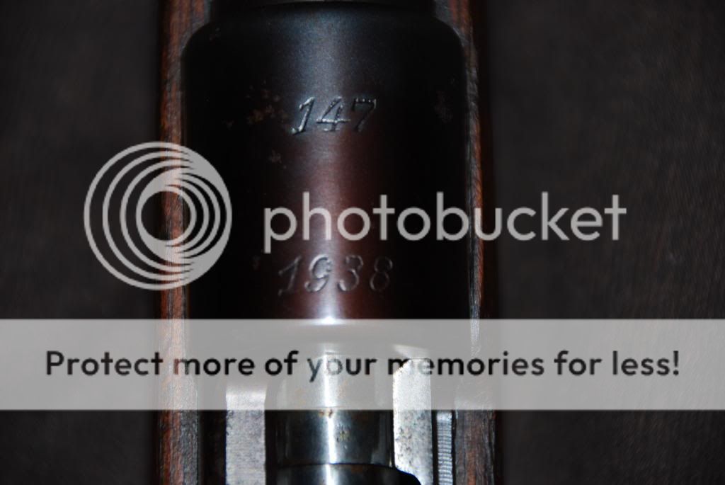

Hi All, I recently purchased what is said to be an authentic vet bring back K98. So far I have found out that everything appears to be matching and was produced by J.P. Sauer in 1938 ( 147 ) .. The only things that I see missing are the front sight hood, cleaning rod, sling and bayonet, but everything with #'s is matching, I have not gone to far with cleaning as I would like to preserve the patina that is on this rifle. I removed the action from the stock to inspect and check the #'s and it looks like it has been many years since the inside of this wood has seen the light of day. I have fired this rifle ( about 40 rounds ) to test function and its flawless. Any more info you guys can provide as to possible value of this rifle would be great. I'm just waiting for the camera battery to charge and then I will post pics....I don't want to use the stupid phone camera!! Cheers All !!

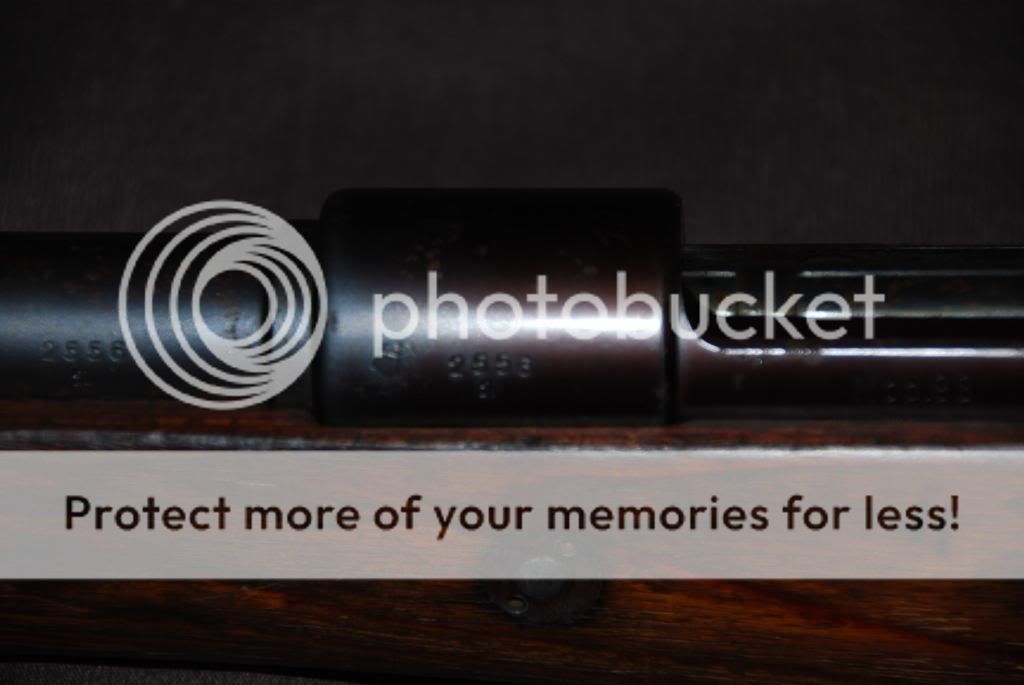

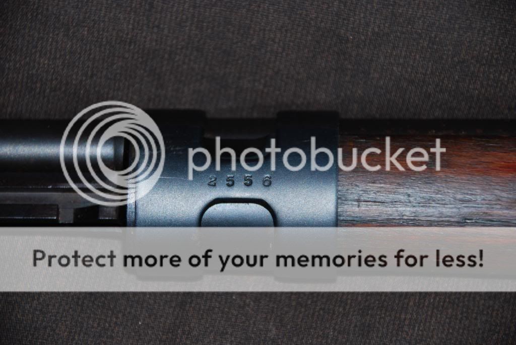

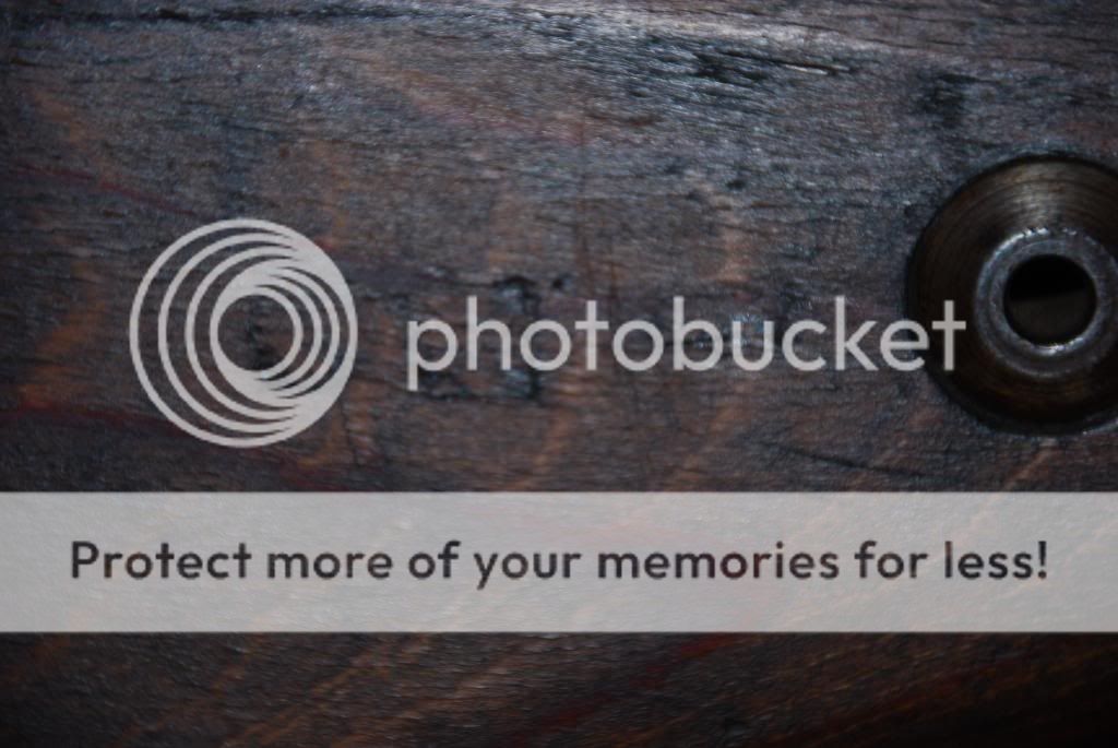

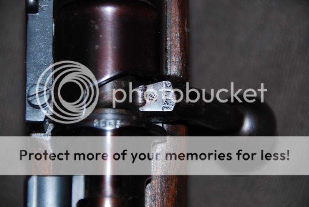

As to value?, we would need more pics of all numbers, and while it is a nice looking rifle its got some issues that I can see already.
The cartouches in the stock look like they have been sanded away and the wood treated. Also the recoil lug is in backwards, a typical sign someone has worked on the wood. Also the safety is un numbered.

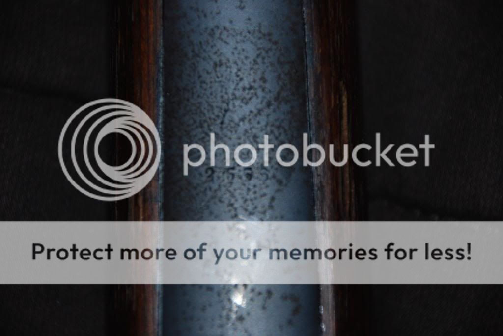

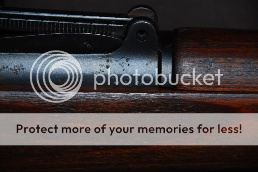

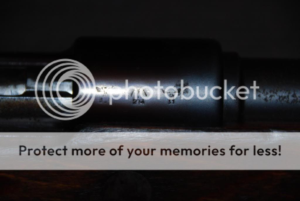

Without more detailed photos it would appear the gun has been re-blued, the biggest red flag for me:
You can see the parts above almost have a parkerized or sand blasted texture, while the finish should be a high polish bluing.

So hard to tell from those pics but I would also say it's been reblued. It just doesn't look like your typical Sauer blue job. Hard to say on the stock as well.
You could post up some pics taking outside in natural lighting. Not direct sunlight but in some slight shade or during an overcast day. That will help show the true color of stuff. Close ups of the sling and bolt cutouts will help determine more with the stock.
It's definitely a nice looking K98k though. I would like to see more of it.
The side acceptance are no worse than the ones on the Sauer I used to own. If it has been reblued, I would say it wasn't polished any further. It just looks blued over the pitting. The bolt cutout looks crisp from the one pic so I'm not sure on the sanding either.
Clear well lit pics are needed to make any sort of further assessment of it in my opinion.

I disagree. Look in Karabiner and the pic sticky reference, dont see many with markings that washed out on the right side. They are actually quite crisp on most.
The edges of the sling cutout look rounded, as do the edges of the stock, better pics would answer it for sure though. Its definitely been treated with something though.

The thing I don't understand is that if it has been polished then why that one area only? Why not take out some of the pitting and do the bands etc.?
Tough to say at this point. I'm just arguing for the fun of it now.:p
If I was going to argue strenuously that the rifle is OK, I would have to argue maybe a depot rebuild, but I personally think it's a post-war reblue with a sanded stock.
Thanks for all the info guys, but most of you are right about the pics. I'll try to get better ones this weekend out in the yard but that might be kinda tricky with all the snow. The rifle looks much different in the pics than up close. Even if it is a rebuild or whatever may have happened I'm not in this thing very deep at all so I might just keep it and shoot it some more. But only after a little more investigation and pics for the guru's to examine maybe we can be closer to figuring out the history of this neat rifle. For now it has a good home in my small milsurp collection. Thanks again for the info and please keep it coming.
