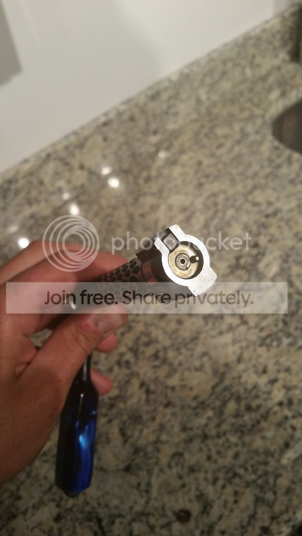

I am working on a load for my .284 F Class rig. (found here http://www.canadiangunnutz.com/forum/showthread.php/1214206-My-first-F-open-build ) Things are going well and I found some nice tight grouping at a pretty hot load. 180gr Bergers 55.40gr of 4831sc. While tweeking to the tenth of a grain I'm finding my primer pockets are pretty much gone and I'm starting to get some bolt face erosion. Primer pockets are now 2 thou over.

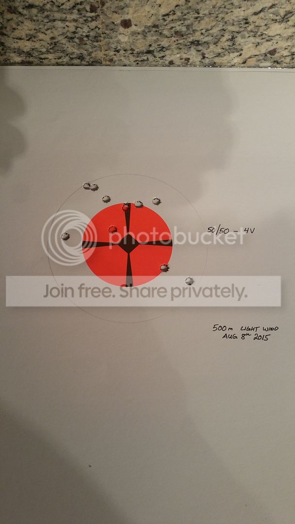

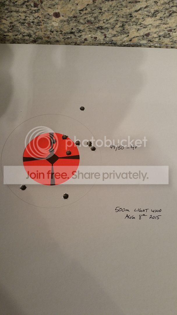

Here is the problem. Today at the range ---- shooting for score and not for group size ---- she shot lights out. Brutal bolt lift and some brass transfer onto my bolt face. I've never had grouping like this at 500m. 50s, 49s, 48s, all with 4+ V Bulls......it was pretty breezy today too.
