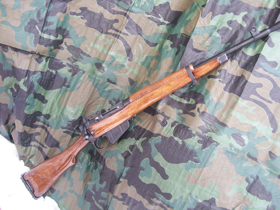

need taller front sight 303 Mark 4 Fixed

Remember that the Army specified that Lee-Enfields be zeroed with the bayonet fixed. Rifles were zeroed @ 300 yds using the larger battle aperture which meant that bullets would strike 8.5 inches high @ 100 yds (all taken from "Shoot to Live"). That's a very realistic zero when engaging man- sized targets because it meant that the bullet would strike anywhere between the knees and head at practical ranges. Troops were, and still are, taught to aim at the center of mass.
I think I am speaking for a large number of people who would appreciate it if you all didn't run out and "modify" your Lee Enfield rear sights. Front sights of all different heights can be found on Ebay among other places.
Doesn't really matter what you appreciate, it's his property and he's entitled to do what he likes with it. It's a sporter No.4 and having it hit to POA and be functional and actually used by the owner is much more important than your concerns over originality.

I haven't gone thru every post, but in the past I've had the front sight built up via a weld and subsequent filing/machining
I was lucky to have an acquaintance with these skills.
