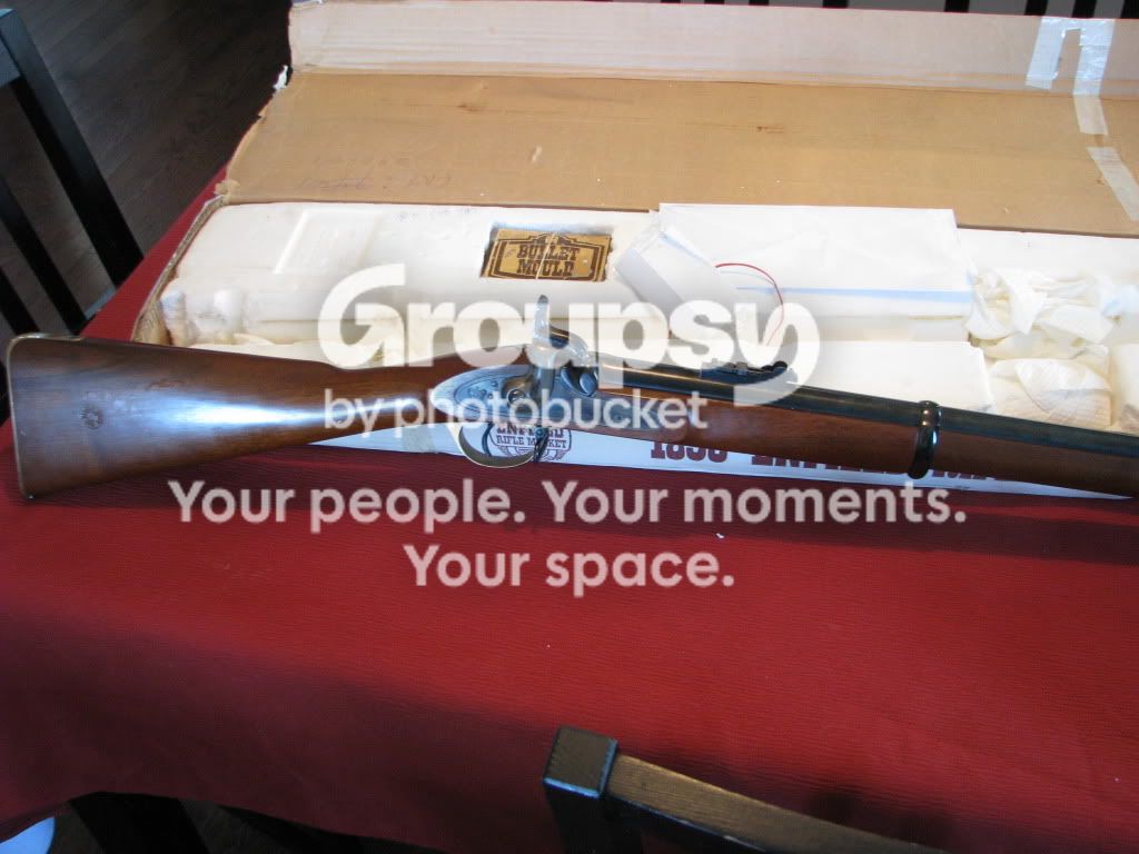

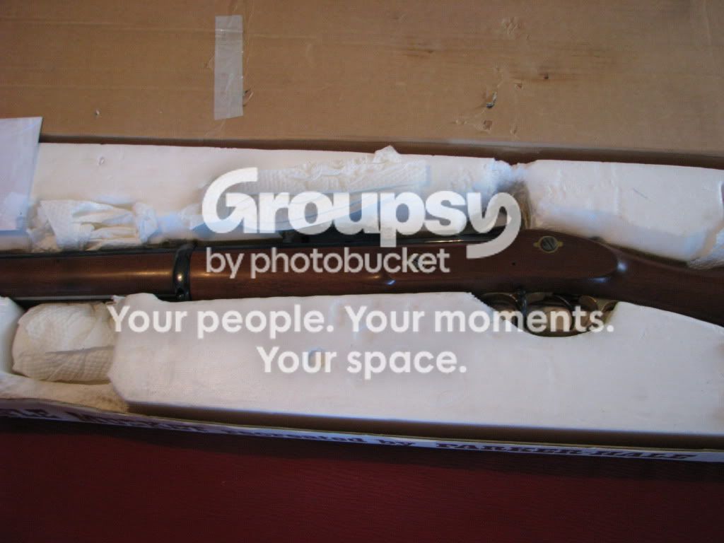

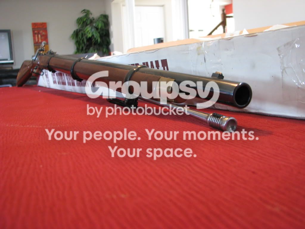

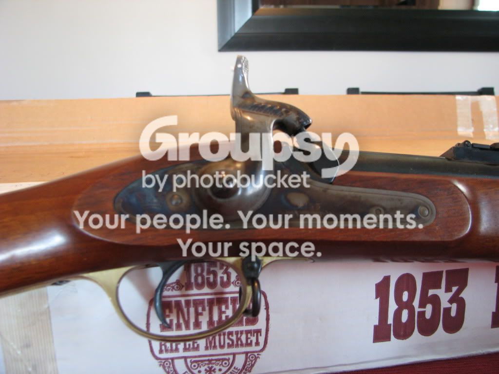

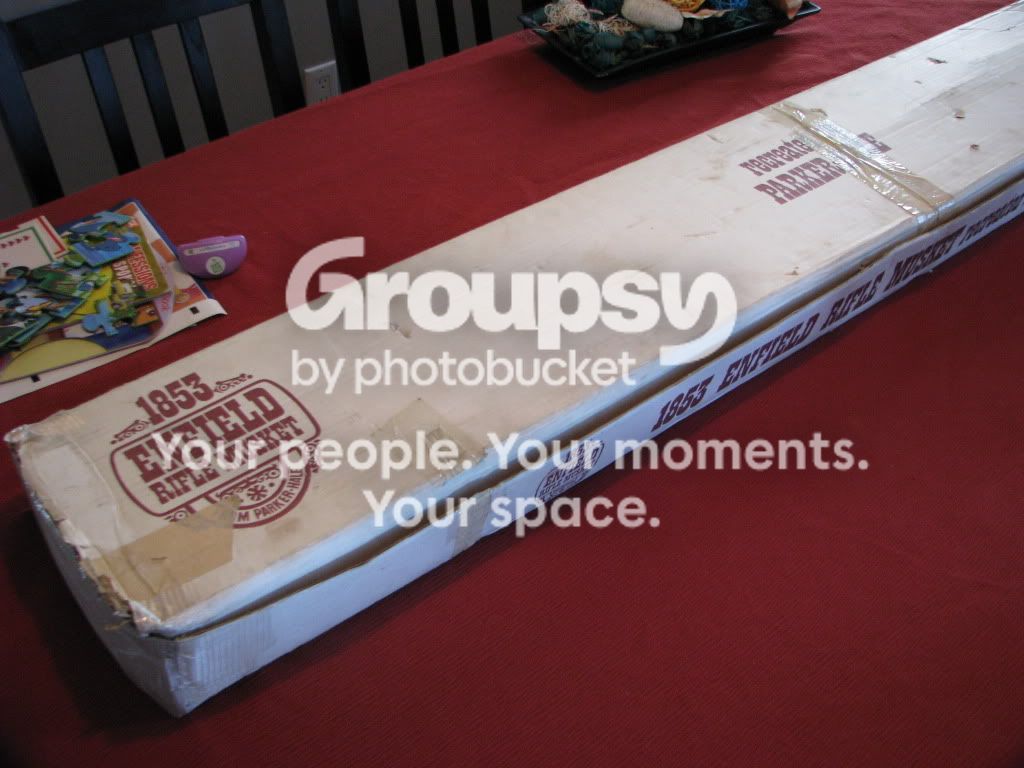

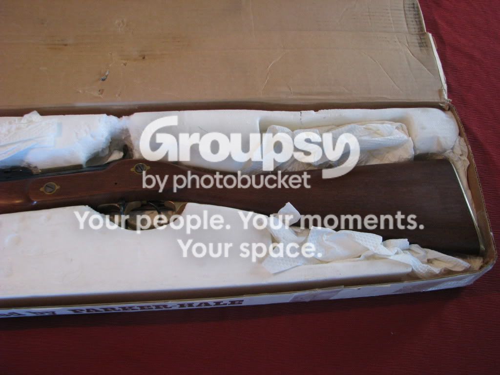

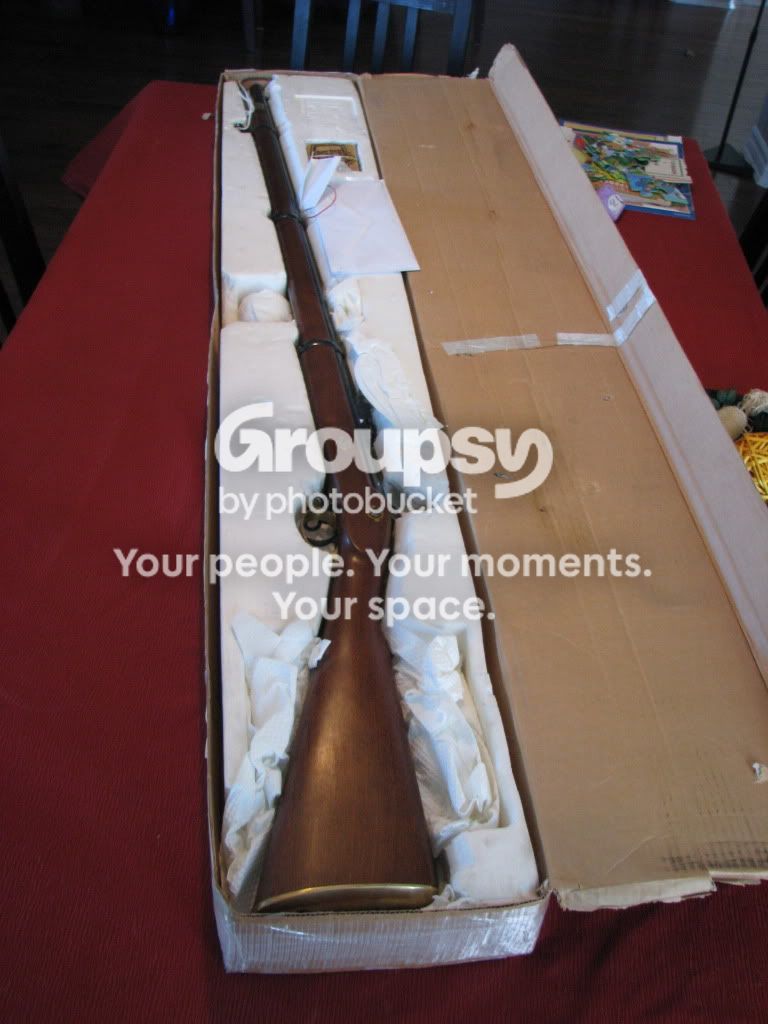

I recently picked up this unfired NOS Parker Hale 1853 rifle musket, made in England early in production.(3### s/n range)
Next Saturday I am planning to shoot it at the club black powder shoot.
I have 3 different types of bullets.
1) The ones that came with my PH Musketoon.
2) Some I recently bought from Road King.
3) The packet of original bullets that came with the Parker Hale new.
All are .577 or .58 minie balls, hollow base.
I had shot bullets from group 1 in an original 1853 rifle(or musket, couldn't see any rifling) last year, and I had to actually pound them down the barrel with the ramrod, they were far from a loose fit.
In the book Death to the French I was reading, the soldier Dodds had a mallet he uses to pound the ramrod down his Baker rifle barrel to get the bullet through the tight rifling, let's face it, you're cutting lead and actually rifling the bullet as you push it home.
Now, I tried all 3 bullets into the PH muzzle with my fingers yesterday. All are tight, none will just fall in. Surprisingly, the PH original bullets were probably the tightest of the 3. So, this is as intended.
I got a bullet starter through the kind efforts of my buddy SchneidersAuto. Thus hopefully I can get them to start down.
What to do then, should I bring a dead blow hammer and actually tap the ramrod? Maybe with say a fired off shotgun hull over the small end of the rod?
Rawhide mallet?
I know there can be no air space, it has to be tight on the powder, but not banged on so hard that you're deforming the bullet.
Also, lube? I have the remnants of some Remington Black Powder Wonder Lube.
Some use Becel light margarine?
Any tips appreciated.

You do not "pound" bullets down the bore of a fine rifle like that. A lubed mini should slid down right on to the powder with a gentle push on the ramrod.
A round ball with a linen patch should take a bump from a short starter and slide down very nicely with a bit more pressure.
Pounding the ramrod to get the bullet to the powder just may bend the ramrod and may also damage rifling.
Find a bullet that matches the bore. A 0.560 or 0.565 round ball with a strong cotton or linen patch should slide down very easily.
That is a fine rifle you have - it does not need the bullet pounded down.
BTW: don't even think of using the Lee Real bullet in this gun. It will hang up on fouling and give you grief getting the ball out. IF you get a "hung ball" or leave space over the powder and fire it there is a very good chance you will burst the barrel.

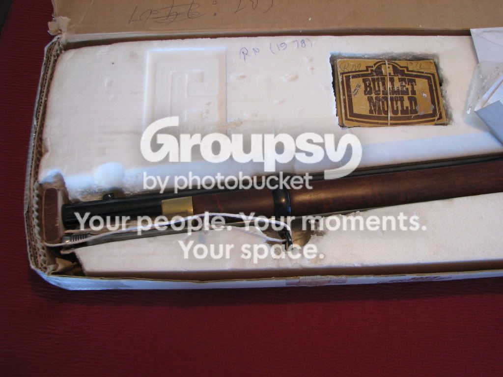

I found one of these back in July of this year. It was also new in box unfired made in 1978 and came with the PH bullet mold. An incredible find I might say. Here she is:
I had a custom range rod made for it out of brass to protect it and got a spinjag in 58 for it as well. I've taken it out twice since receiving it and here's what I've tried so far.
I don't have the time to cast so I have a local bullet seller name R&R Bullets in Maitland Ontario and he's provided 560 grain .575 Lyman PH mold Minies, 460 grain Lyman 575213(OS) Minies, and .570 round balls. I've read that FFFG is cleaner to shoot but reduce my loads by about 10% so that's what I started with.
I've only tried the 560 grainers and round ball so far. I started at 30 grains FFFG to see what I got at 25 yards with the Minie. It tumbled. Up to 40 grains, bingo, straight in. At 40 grains I moved to 100 yards to see what I got. It was about 8" low. Upped it until the sights were on elevation wise, at 65 grains FFFG. Windage on the sights are bang on. Best group was at 50 grains about 3" below the aim point. Best 100 yard group size was off sandbags and measured 6 or so inches. At a 100 I couldn't get the PRB on paper. I tried a few various charges up to 80, but I figure I'd save that for another day. The 575213 are up the next time I'm out with it. I've read that you have to keep the charge reasonable with the 575213 as it's easy to blow out the skirt. I look forward to finding out.
I lubed the base of the bullets and the cannalures with Wonder Lube. It's all I had on hand. I picked up some beeswax and crisco lube from a fellow nut and will try that next time. The bullet loads fairly easy. It's kinda hard to describe accurately. It pushes into the muzzle with light push from my thumb. It doesn't fall on it's own, yet only requires a few pounds of pressure to push it down the bore. I find this the whole time I'm shooting. I've shot 40 some through it in a day without cleaning and it was the same loading pressure on the last shot as it was on the first. These are a hell of a lot of fun to shoot. I like it so much I have a PH 1858 Naval pattern made in the seventies as well due in December.
I'd like to know your experience as you learn as well.

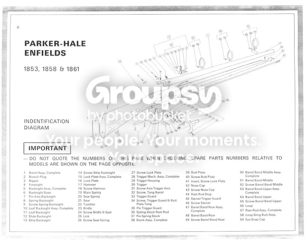

I picked up the PH Enfield sergeants tool from Dixie Gunworks. Neat to have on hand and makes taking it apart pretty effortless.

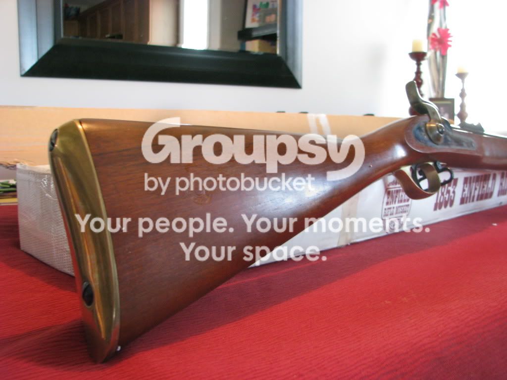

The pics shown are from the day I got it in the mail. I've since put a nipple protector on mine too. I have a sling to put on it, but I have no idea how it goes on. Do you know? I like the look of the strap hanging under it, seems more authentic...
