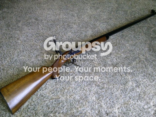

Woohoooo! My new toy arrived from The Gun Room. Brand new Pedersoli Gibbs target rifle. It is a beauty! I have been scheming away all winter (yeah, it's still winter) about owning one of these. As soon as we got home from our winter home in California, I cleaned up a couple of underutilised Fender guitars and an amp, and put them up for sale, and what do you know? They sold for what I was asking, and here we are!

As mentioned above, Dave sent me a selection of bullets, and after I got the packing grease cleaned out of the bore, one of them fit, sort of. It was tight, and I could only load it clean, it wouldn't go into a dirty bore. I fired 3 shots yesterday, and here's initial thoughts.
Fit and finish are good. The barrel fits the stock and breach like a glove.
It is a lot of rifle, almost 12 pounds, but balances perfectly right at the barrel wedge.
Because of the weight, and the heavy 36 inch barrel, recoil was minimal, but then, I only had 75 grains of powder in her. Much, much less recoil than my 45/90 Winchester!
The sights are good, in spite of what you may read about them. I am pretty sure they will outshoot me for the foreseeable future, and I am in no hurry to spend another $500 on a "better" set.
The straight stock makes it hard to get my eye down low enough to shoot it at short range, as has been discussed on this site before.
I can't really get too serious about shooting it until my mould arrives. I plowed a 100 yard path out in the pasture with the loader, but it keeps blowing and filling back in with snow.
By the time the mould gets here, we will be sowing (I hope!), so a proper range report is a number of weeks away, but I couldn't wait to show her off! Man, this is going to be fun!!!
