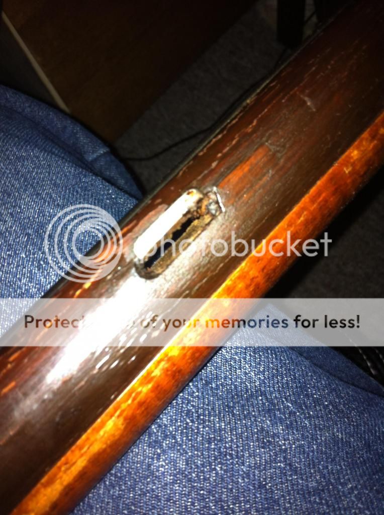

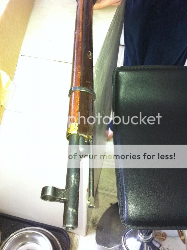

Nice pre-war handguard... The stock however... That could use a bit of refinishing
I've got a couple with brass like that. But my stocks are much better.

I have 2 as well, it is just random luck. They used to make the caps out of copper and brass well before WW2 and during refurbishment some newer rifles got them from the parts bin. They would be most fitting on an 192X converted dragoon rifle. I would say the stock is actually in great shape it just needs to be stripped with denatured alcohol and have the shellac reapplied. Shellac wears off quite easily with use.
I have been looking at the best choice of shellac to match the original color I have and I think it would be garnet shellac. I find it stange how there is no markings or damage on my stock except the shellac. Kinda excited to see the barrel, hopefully its good shape.
