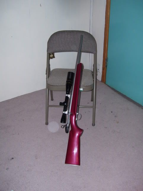

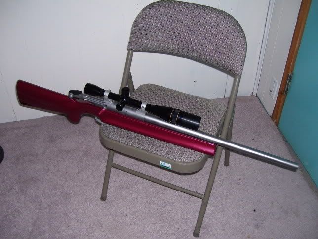

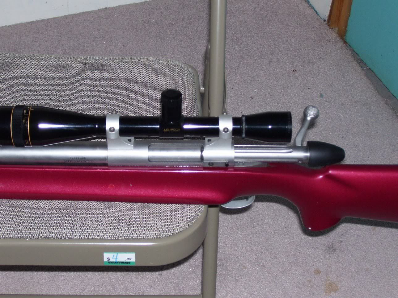

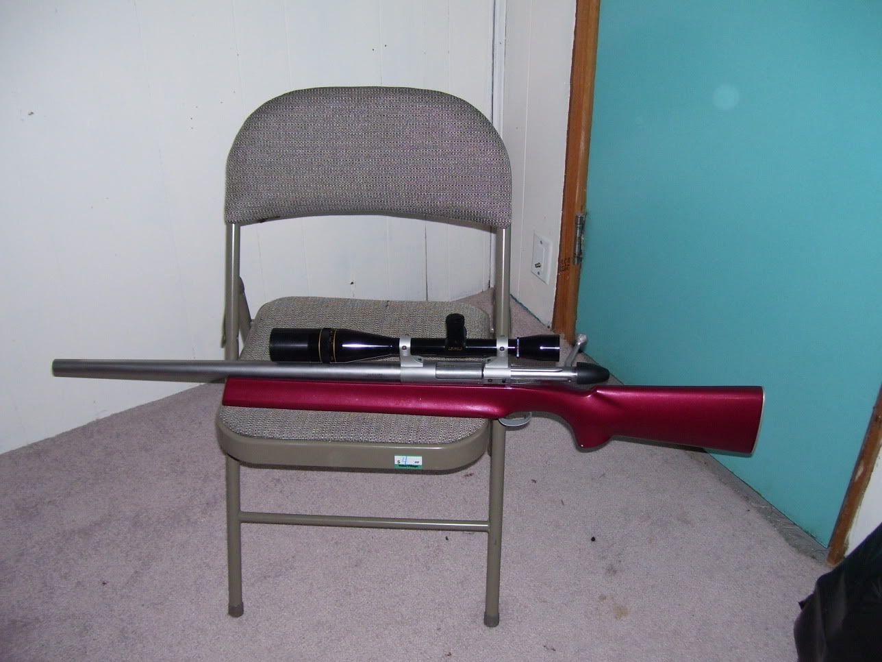

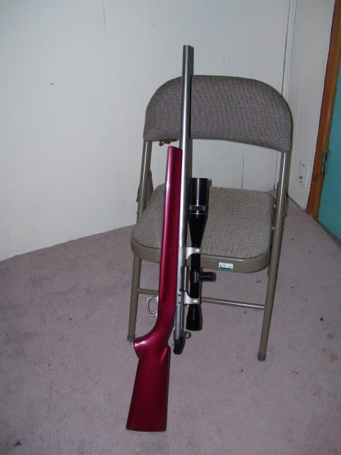

Well I finally got to try it today I shot all aprox 3/8 groups just fire forming brass can't wait to tweak a good load I think this one is a definite shooter I just threw together a load and rough measurement of oal and it was a bit windy with noflags
Sounds good....flags will work wonders if you can respond quick enough for the conditions. What scope are you using?
### I am using a 36x leupold I think x44 objective I didn't bother with flags today as I only wanted to fire form brass but I was impressed by the grouping my 22 br shoots better groups than that but the brass is formed and the loads have been worked up and oal was tweaked but when it comes down to it my 22br didn't shoot as well as the ppc the first time I tried it but now I get a lot of groups in the ones with it so I am guessing the ppc will be an awesome shooter once I get the right combo
I will try to post pics by next weekend it is a wichita br action left hand port right hand bolt mcmillan stock gaillard barrel and 2oz jewel trigger toped by a 36x leupold scope.

however it may not be a jewell 2 oz we know that 1 of the 3 guns had a jewell and 1 had a jart 2 oz the other we don't know the trigger shoe should tell you and I recall it was quite wide so it may not be a jewell
paul ross would know so when you come to the june 3rd shoot paul can tell you for sure.
