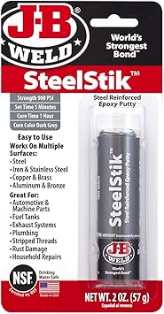

Sounds similar to this, works great
This stuff is the best release agent i have ever used. Parts pop apart.
Thanx for that, I picked up a dozen tubes yesterday at the Kelowna PA. They have it on sale for $5.99 each. It's different from the other stuff that's no longer available but was aluminum based.
This may actually be better as it has a much higher strength rating at any temperature we're likely to use it at. 900psi Steel, compared to 600 psi Aluminum.
I will be trying it out on a couple of bedding jobs next week.
Thanx again
