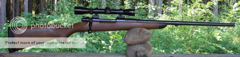

It's another JC Higgins M50 action that has been modified and re-barreled by Bill Leeper to .375 Ruger.
After a couple of discussions with Bill, we decided to use a McGowan barrel he had on hand. The final length is 21" with a .69" muzzle diameter. The crown is a target-style
Along with opening up the bolt face and modifying the extractor, It's pretty obvious that Bill had to do extensive work on the feed rails and lips. I'm not sure if the feed ramp needed modifying but it was highly polished. The top sides of the mag box have been thinned as much as possible so that the stacking angle of the loaded rounds is reduced.
All the mods really paid off. The rifle feed, extracts and ejects flawlessly. The feeding is especially impressive. The big, fat rounds chamber as smoothly as the original .270 Win rounds.
The extractor has been modified so that it is easily possible to close the bolt on a chambered round. The use of the Vulcan extractor squeeze is required.
The barrel band looks like a Talley and the trigger is a Timney at about 4 lbs.
As much as I don't mind the curved bolt handle on the FN action, I prefer a straight, Talley-style handle. Bill did a fine job and the bolt knob misses my knuckles during recoil.
I used the original stock but with mods. These include shortening the forend and installing a ebony tip. The grip cap and bolt stop shelf are also ebony. I lengthened the pull to 14" by installing a 3/8" thick piece of ebony between the butt and the 1" Pachmayr Decelerator Old English pad.
I installed internal cross-bolts behind the recoil lug and behind the mag box. The stock had a small crack behind the rear tang so I cross-pinned the pistol grip with a piece of 1/8" brass rod epoxied in place. The action(including a couple of inches of the barrel) and the bottom metal is glass bedded with Accra-gls gel.
I must say that I don't like the shape of this stock. The excessive drop at heel prevents me from getting a decent cheek-weld when shooting. The rifle also likes to rotate upward excessively during recoil. When I find a decent piece of Walnut at a price I can afford the stock will be replaced.
Once I got the rifle back and finished the stock mods, I slow rust blued all the metal and refinished the stock.
The rings and bases are steel Talleys and I'm currently using a leupold VXI 2-7X33 scope(the VariX in the pictures has been swapped out)
All in all, I really like the rifle. At 9.5 lbs fully loaded and with a sling, recoil is civilized and the rifle is still light enough to pack all day.
I've done some shooting with 225, 270 and 300 gr bullets and accuracy is running from .80" to 1.75" at 100 meters. Velocities are on a par with .375 H&H loads out of a longer barrel.
