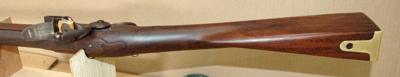

Just finished building this for a friend.
The walnut stock is finished with pure tung oil.
The unmarked 42" .62cal. smooth-bore barrel is believed to be a Colerain.
The lock is a Davis trade gun flint.
The weight is 7 lb. 13 oz.
Gotta do something about those shiny screws in the lock:redface:

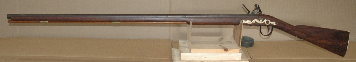

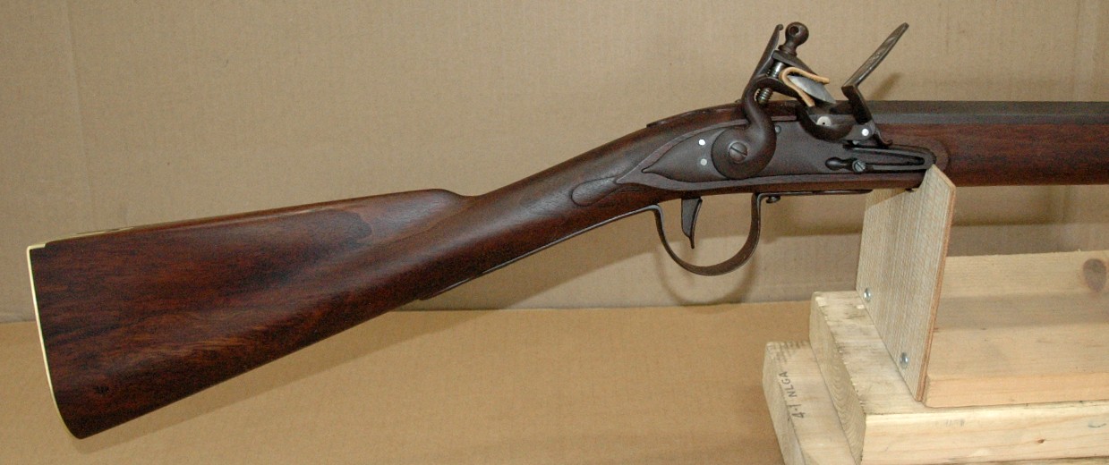

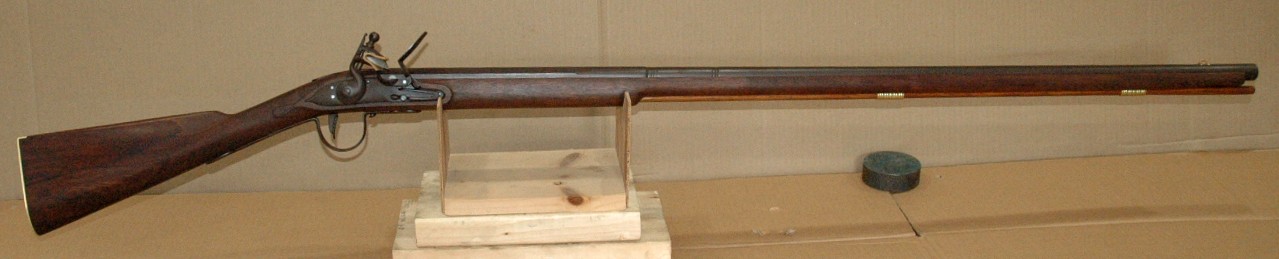

Here are some photos from my files:
Here are a pair of trade gun locks. Many years ago I was involved in manufacturing reproduction NW guns. I put the unmarked one together from left over parts; the one with the tombstone fox is an Upper Missouri Trading Company lockplate with my left over parts. I think Upper Missouri used the same lock to make their wax casting dies that we did.
I put this gun together thirty odd years ago. Metal parts are all left overs from our production, apart from the barrel which is a North Star. Stock cme out of a 2" cherry plank.
