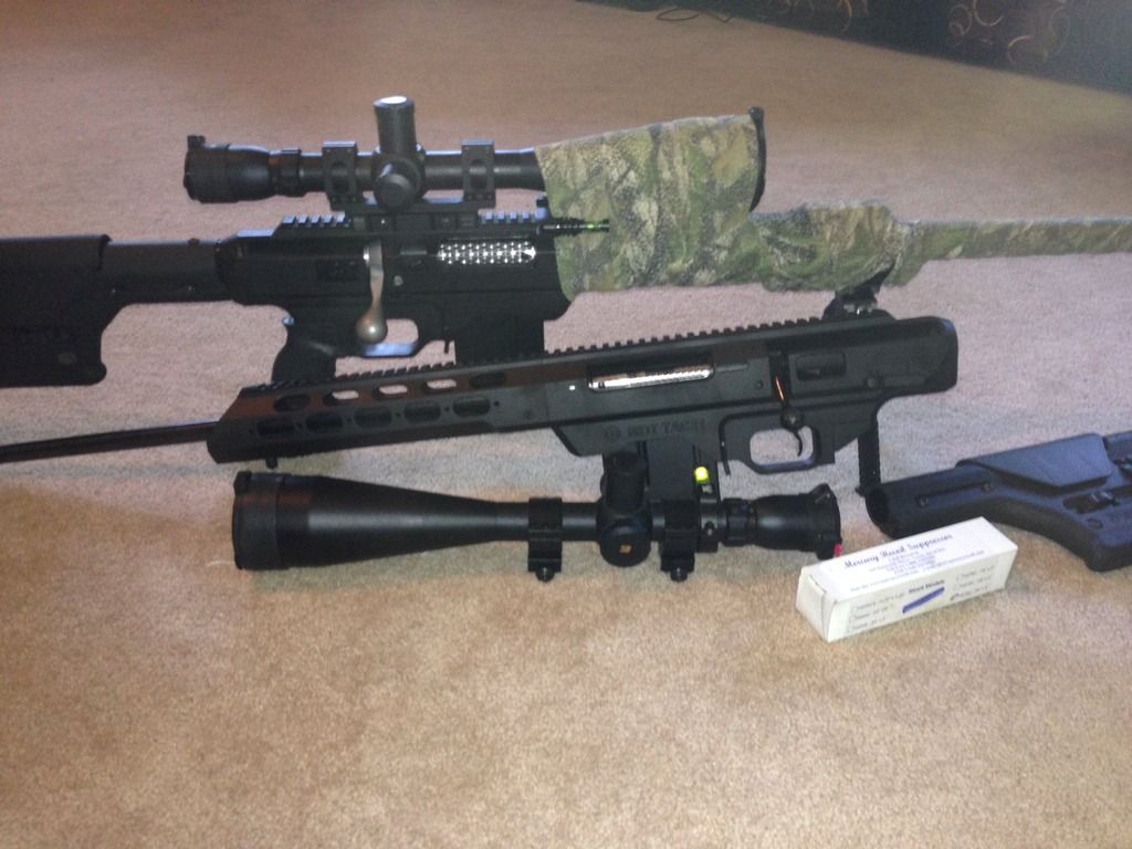

Here's what I've got going on,
Left hand savage 114 Long action
PTG bolt head
Basix trigger
Mdt tac21
Magpul PRS
Mercury recoil reducer
30" bartlien 5groove 8twist
Glades armoury bolt handle
Sightron s3 10-50x60
Vortex rings and level, I might switch to adm qd unimount.
Redding comp. neck bushing and full length dies.
That's her so far, waiting on a buffer tube and getting it rebarreled and the action bedded into the chassis.

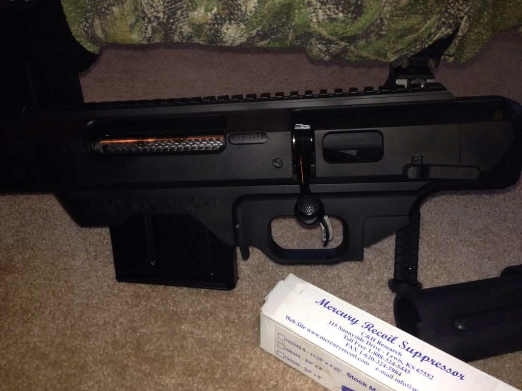

This is the first left hand long action chassis mdt made, so I sent them my donor action to make sure everything works ( that's why it's assembled, it came to me that way)
Sorry for the crappy pics. The rifle will basically be a left handed clone to the one in the back round.
