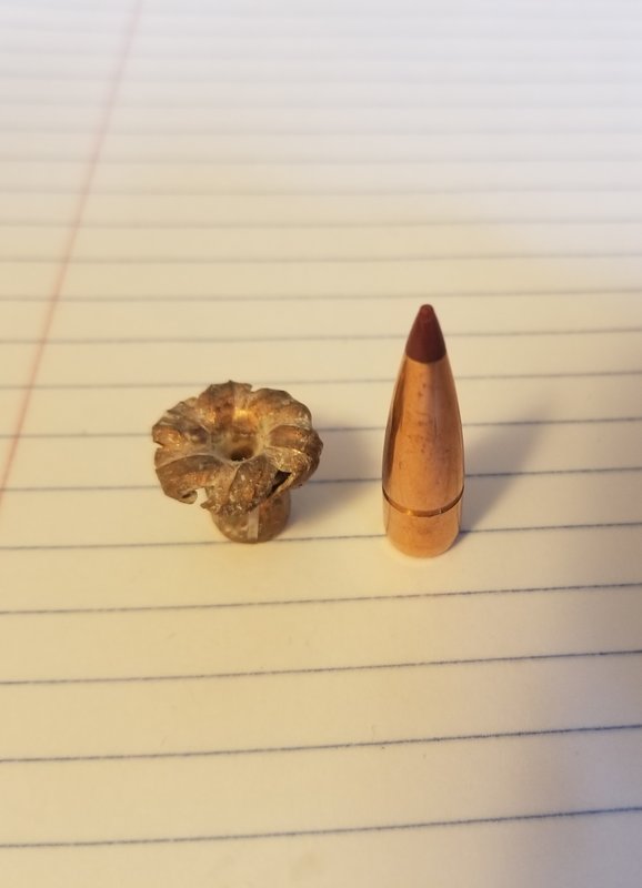

This year's deer load: 110gr Hornady CX at 2400 fps muzzle velocity. Seems to be doing just great at 100 yards.
I'll be taking a few with it this year and consider it to be up there with a 30-30 level of performanc. Same with the 110 and 120gr Barnes Tac-Tx.
Would say more about what those can do but so far, only data point is my bud shooting them in the head and we all know that's not really going to show off failure. Does a number though lol.

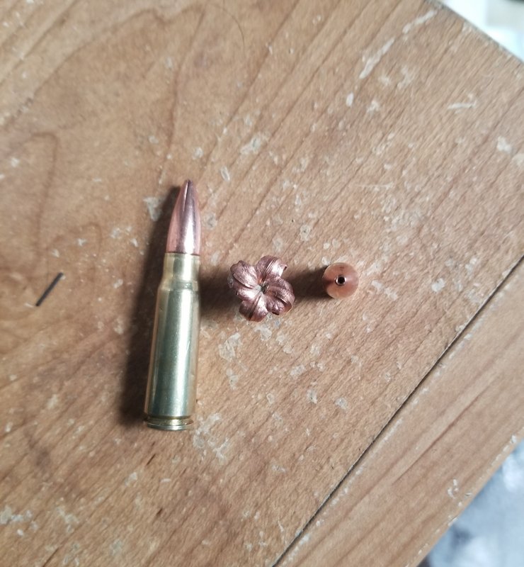

In this case I'd say they really do help a small round (300 Blackout) punch above its weight. Would love to see what they do from a 7.62x39mm as well but besides shooting paper, haven't done much. Replaced them with 123gr E-Tips and 123gr TSX in that caliber. Which also seem to be expanding just fine. Again. Hundred yard result.
How will they do on non headshots? Excited to find out! And I'd also consider the 7.62x39 with that load to be solidly into 30-30 performance.
