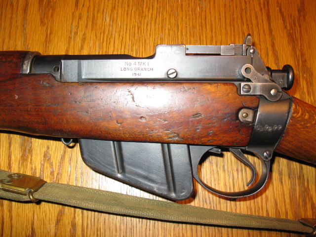

60 degrees eh? Just like another Canadian-made action.
